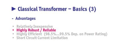

From my knowledge, conventional transformers are less expensive and more reliable. It's hard to beat the reliability of wire and iron. Conventional transformers are also highly efficient (~99%).
https://www.pes.ee.ethz.ch/uploads/tx_ethpublications/__ECPE_SST_Workshop_2016_SST_Concepts_Challenges_Opportunities_FINAL_JWK_270116.pdf
(See page 14).

I studied this report already .. but the thing is I want to know . Did anyone do some work on this project?
