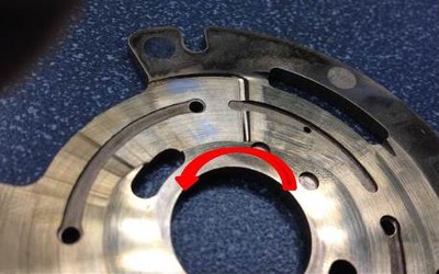

Hello everyone, no time no see; health issues. Anyway, I'm consulting with a company regarding some hydraulic pumps and issues with these. These are vane pumps, single and double pumps, and on the smaller replaceable pump cartridge in the double pump, and on the single pumps which use a small displacement cartridge, I am seeing some unusual wear, in particular on the bronze plated "flex plates" installed between the cam ring and support plates. (1) It appears the vanes in the cartridge are literally milling out the bronze stock as it is in operation. I have seen a large number with this wear, and two were worn down to the steel back. Note, it is NOT a burn, but literally material worn away. (2) This is limited to the intake or suction (low pressure) side flex plate of the pump. The flex plate (they are the same plates, by the way) on the discharge (high pressure) side of the pump is not seeing this type of wear. There is some wear of the type I have noted in the past on this discharge side plate, but not as with the suction side plate. I have found these are being used in Canada and the U.S. Pacific Northwest; 15W hyd oil in use. The application is a boom truck with an auger. I'm told these are supposed to be balanced hydraulically with no axial loads/forces, but it appears some type of axial force is occurring. I've had parts measured, but nothing appears to be out of spec. Thank you.

Cavitation? (Just a WAG.)

Re: Unusual Hyd Pump Wear
01/19/2017 4:16 PM
Have you looked at particle analysis on any of the oil where this wear is showing up?
The thing that I find vexing is the isolation to the low pressure side of the pump, not the discharge side.
Maybe our buddy is right about cavitation. It is possible, especially if the fluid is contaminated with high vapor pressure product, or is wet, etc. Do the pumps become louder on long-term operation (say an hour or two after starting up)?
01/20/2017 12:03 AM
A few questions
What pump model is it?
What pto percentage are they using?
What is the max engine rpm setting?
Over what time period does this wear happen?
Can you share a picture of the damage?
As for cavitation that will show up on the vanes more than anything. It first shows as pitting but progresses to something that looks somewhat like disolving. Do these pumps have that kind of damage?
01/25/2017 9:02 AM
Vickers 2025 double pump (failure in the 20 cartridge, the 25 is not impacted), standard performance, and the Vickers 25 single pump, high performance model.
We are waiting on PTO and rpm information. The time frame has been anywhere from an hour to a year on the extreme ends. It appears to be averaging 3 to 6 months. A picture of an extremely worn plate has been attached to another post.
The vanes illustrate scratching and mild discoloration, but not pitting or metal removal/transfer/dissolving.
01/25/2017 8:43 AM
Update: I have seen some additional pumps with the indicated wear. In addition, I have determined that the wear pattern moves with relation to how the pump is assembled for operational rotation; that is, there are "forward" and "reverse" rotation pumps. The cam ring/vanes/flex plates are inverted to change the rotation. The wear stays with the intake or suction side with the component inversion. Also, the vendor is using a special oil by Kendall ("Glacial Blue") in this application (Canada/US Pacific NW). We are obtaining a supply of this oil to attempt to duplicate the operating conditions. A photo is attached illustrating the most extreme condition; we are seeing this pattern of wear with varying degrees of depth of the milling of the bronze alloy.
01/26/2017 12:20 AM
Glacial blue is a good low temp oil. We have one major fleet client that used it.
That wear looks to be from the vanes themselves. I have heard of something like this that had to do with a clogged suction filter or strainer, I don't recall exactly which.
I'll run this picture past some of service guys to see what they say.
Also if you haven't found it yet Parker has a great trouble shooting guide for vane pumps.
02/21/2017 9:46 AM
Update: we have confirmed that a 15W oil is in use with these pumps. Also, we have some more equipment configuration information: Engine RPM is 1100, with a 120% PTO ratio for a pump RPM of 1320. Oil temperature is running at 145 deg. F. A concern is the use of a 1 1/2" inlet hose that is 17 ft. long. The engineer I am working with has a concern about sufficient fluid flow. Also, a 50 gallon tank is being used.
So, the next step will be an attempt to duplicate the operating conditions. I have worked with the company to configure a test stand to run the 15W oil at elevated temperatures (145 deg F as noted), and across a range of temps. If the failure is not noted, I will work to reconfigure the test stand to (as closely as possible) replicate the inlet hose setup (17 ft long 1 1/2" hose).
04/11/2017 1:30 PM
Update: Running tests on examples of the product under review. One pump demonstrated the beginning of the milling issue while under test; several demonstrated significant scoring of the bimetallic plate as was seen with customer returns. One had no wear or scoring, only demonstrating some discoloration of the bronze alloy; a light brown color. Upon further investigation, we determined that the 145 deg. F may not be completely accurate as a temperature at the inlet connection; we determined through some modeling and experiments that the temperature is closer to 160 deg. F. Therefore, we aimed for 160 deg. F at 2700 psi. Interesting to note that at this temperature and pressure, a high intensity noise with vibration was generated by the test stand, with an immediate drop of 200 to 400 psi when the noise started. When the pressure was reduced to 2000-2100 psi, the noise/vibration stopped. Upon returning to 2700 psi, the noise and vibration re-engaged anywhere from 5 to 90 seconds later. Also note the pump which did NOT demonstrate wear or scoring never generated this phenomena. My next two tasks will be to re-run the tests with the manufacturer's recommended oil, and also instrument one of the customer's trucks to gather real-time and place data for further investigation.
10/23/2017 1:49 PM
Final update: the organization I was working with has closed this corrective action based upon the tests I helped conduct, information we received from the customer and some internal investigation. Two main things we discovered are the intravane assemblies during machining were being measured is such a way that intravanes with excessive length (above the upper specification limit) could pass through the value stream undetected. We determined this was a significant part of the excessive wear, especially at the higher temperatures and pressures we saw. The manufacturer has changed the measurement process to capture this fault mode. The other issue was what was determined to be excessive length in the inlet plumbing at the customer application. We simulated this and we saw excessive wear once again. The customer has made changes in their system, and has also made improvements to reduce operating temperatures as required. With the improvements introduced by the organization and the customer, it appears that much of the issue has been dealt with, as customer outcomes have improved greatly and returns for the issue to the organization have been reduced by a significant amount. I thank you for all the input.
11/09/2017 2:01 PM
Sorry for the delay. Some of the information is proprietary and I had to ask permission to discuss this. I'll speak in general terms. The intravanes are a 2-piece sub-assembly; I will be referring to the large outer part which has a nose ground to interface with the cam form of the pump's ring, and is ground to length. This length dimension interfaces with the bimetallic internal plates on this design. In the initial grind, the operator runs a sample grind sequence, then measures the parts on a CMM. To avoid having an operator do math, the CMM results printout gives a adjustment factor that the operator then enters into the grinder. This adjustment is based upon (in part) a calculation of length measurements, one of the outputs to calculate the adjustment is average length. The issue was, one or more of the length measurements could actually be over the upper specification limits for length, but the calculation for average could generate a value within limits. It looks like parts were slipping through that were above the limit but classified as within limit. Depending upon some other inputs (temperature, type of oil, others I can't get into), these were driving excess wear under some circumstances. The process was adjusted to avoid this measurement issue and some guidelines were issued regarding approved oils and operating conditions, and some design recommendations were issued to the customer. Hopes this clarifies.
