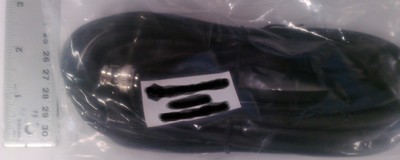

3m plug to plug RG59U coax cable:-
This was a bit of a disappointment I've deleted the label to protect the "guilty": normally a very good supplier.
Surely it's obvious to nearly everyone in the business what's wrong here.
How does a reputable company allow this sort of thing to happen?
Pathfinder Tags: BNC to BNC lead coax cable RG59/U

That '3M' plug looks like a BNC. Is it?
RG59 is 75 ohms and BNC connectors are typically 50-ohm connectors (there are 75-ohm versions also). Not usually a problem below 10 Mhz.
The other thing: the packaging is severely bending the coax (which typically doesn't like anything below a 2.5" bending radius). I would not buy this cable for that reason alone. It should be coiled at least 5" min coil ID and preferably a bit more.

This RG59 is only 75 ohms where it isn't sharply bent!

I've no reason to believe that the BNCs are not 75 Ohms.
But the packaging: the bag itself is not big enough for the 2½" minimum bend radius, but they might have gotten away with that if they hadn't tied the middle of the coil up with a bit of "tie wire." Even after I'd removed it, I couldn't get the bends out of the cable.

Send it back. It's garbage.

I agree that the packaging is a bit tight but I don't see anything "obvious." Can you tell us what your issue is?
Re: Spot the mistake
01/24/2017 1:50 PM
The scale next to the package is a clue.

Cable like this has a characteristic impedance, related to the insulation and the diameter of the inner and outer connectors. If you bend it and it is foam core especially, this ratio can change and create an impedance change. Normally not a problem, but it is frequency dependent, and at higher frequencies the impedance 'bump' can cause small reflections, which might be a problem. A time domain reflectometer can test the cable at the intended frequency and assess the risk. Normally it sould be sold coiled around 10 inches or more across.

So I was not specific in stating "how tight" I thought the packaging was.
I'm very aware of what happens when you "kink" coax. don't ask how I know that.

I never thought foam core insulation worth poo on high frequency/speed cabling.

Poo insulation is really shitty for high frequencies. But on a serious note, all cables are tested for a minimum bending radius which is normally 15-20 times the diameter of the cable and wires are turned on a specifically sized mandrels, to check for insulation cracking. They are also normally tested for flexibility on a machine that runs for x thousand of cycles while a voltage, amperage is applied. So I am a little surprised the foam bending affects the frequency so easily.
I agree, that item was badly vacuum packed.
