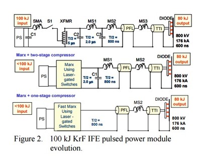

Re: High pulsed power
01/25/2017 8:10 PM
Sandia's Z-machine discharges a pulse of 18 million amperes in under 100 nanoseconds. They use capacitors.
50 us is leisurely for capacitors, but minimising inductance is key. If you don't manage it, it can put severe constraints on your pulse risetime. What is your coil inductance?

01/26/2017 5:28 PM
btw they are switching to linear drive transformers instead of capacitors
01/26/2017 6:18 PM
Linear transformer drivers. They sure are, and those too use capacitance to store the energy.
