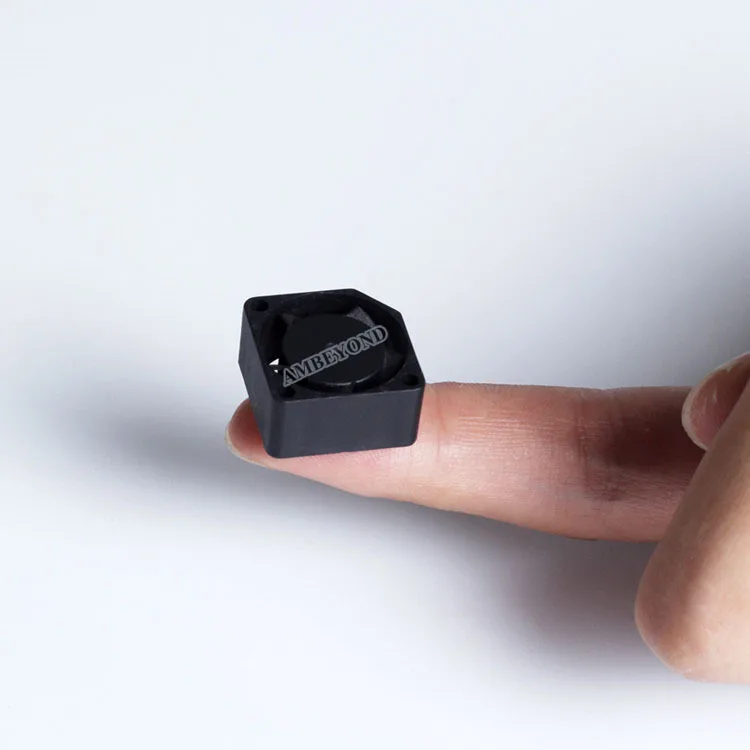

Maybe stage a few of these?
Re: a new question about axial blower
02/12/2017 1:50 AM
They're cheap enough.
