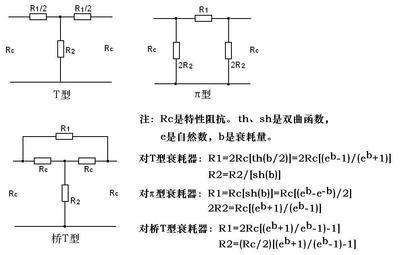

I am going to develop a project with attenuators used in optical fibers at home. Before making, I need to make clear the working principles for attenuators used in optical fibers, in other words, through which technologies can attenuators be applied into optical fibers.

After getting to know the theories of attenuators used in optical fibers, I have outlined a circuit that does not work. I have no ideas why it does not work or where something goes wrong.
So I need your help: how could the circuit be possible to make it correct and work well ? What is your idea ? Any of your ideas would be highly appreciated.

Your diagrams are electrical attenuators. They have nothing to do with optics.

Actually they do. Like most things in engineering, the formulas for different disciplines take on similar forms. In this case the parallel elements represent the scatter losses to the fiber sheath (analogous to shunt capacitance), while the series elements represent the losses to the fiber path (analogous to series resistance). The formulas use decibels instead of Ohms.

Sorry, I fail to see what you are trying to achieve. Why do you want to implement attenuators in your design? What are you designing? Looks like your 'explanations' are a cut and paste from somewhere. Is this a university question?
Why I ask...Most reasons for requiring attenuators is that the optical transmit power (usually measured in dBm) is too high and saturates the optical receiver.
Yes there are a few methods to achieve this and one is an air gap. This is not recommended for multimode fiber in a practical sense. How will you effectively 'fix' the distance permanently to get a reliable constant result?
The second method you mentioned is also known as an MCP (industrial terminology for Mode Conditioning Patchcords). This can also be achieved by a good brand of fusion splicers that allow intentional misalignment in micrometer increments thus a calculated attenuation.
Another approach is to use optical splitters. They can be purchased in any ratio ie 90:10, 80:20, 70:30...all depends on what you are trying to achieve.
Optical filters is also another method, but usually reserved for WDM applications ie to filter through only the required wavelength. WDMs also have IL (Insertion Loss) factors which also contribute to attenuation.
