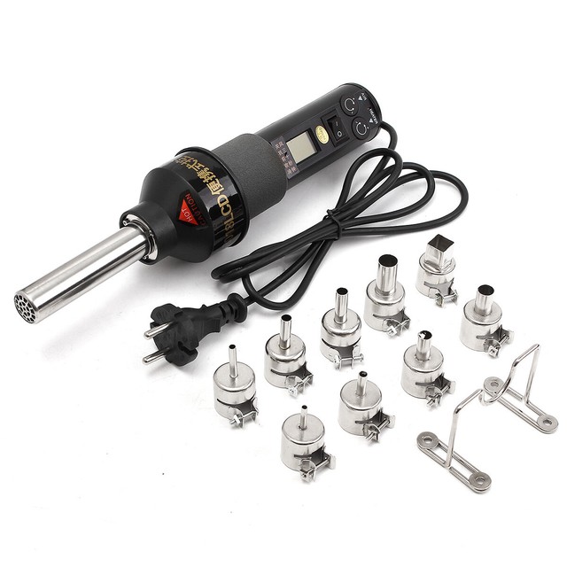

Work such as yours is accomplished with a tiny heat gun [hot air wand]. Other areas are masked off with mylar tape [heat tolerant] and the hot air is applied only to the part. When the solder melts the part settles into position by the surface tension of the liquid solder. There is a dance to be done between blowing the part, or others, off of the board before the magic happens. To help that case, preheating of the board always helps. Typically there is another heat-gun below the board in a bracket assembly holding the board using very low heated air volume. The board is warmed up so that the application of the hot air wand can be very brief limiting stress on the parts to be soldered and adjacent parts.
The reflow process could be done with a soldering iron applied to the part. I would never do this for anything I intended to deliver to a customer, I consider it a post apocalyptic need it to survive tactic only. You want to heat the part as evenly as possible. Might seem funny but put flux on top of the part if you try this.

I will check and see what my electronics supply house has to offer, in terms of hot air pencil, paste solder, flux, etc. I think I might try several of the various suggestions, and get pack with the panel and report what is really easy for a one-off solder job like this. I am not selling the finished product. That might come a few years down the road, but certainly not right now.
