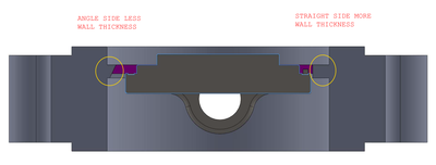

FINALLY I HAVE DESIGNED A TRIPLE OFFSET VALVE
BUT I NEED A CLARIFICATION
THAT AS MARKED IN THE DRAWING
THE ANGLE SIDE IN THE BODY IS WITH THE LESSER WALL THICKNESS
AND STRAIGHT SIDE WITH MORE WALL THICKNESS
BUT WHEN I REFERRING THE CATALOG ITS VISE VERSA
CAN ANY ONE EXPLAIN ON THESE PLEASE (AND HOW DOSE ANGLE DETERMINED)

You are asking us to help you commit a crime by assisting your efforts in stealing someone else's intellectual property. Why not just look at some patent filings and copy them directly, instead of advertising to the world how you "design" something. I guess that your next queries will be how to forge test results and which documents to counterfeit to show that your products meet all applicable standards.
Re: Triple Offset Butterfly Valve
06/14/2017 10:22 AM
Please STOP SHOUTING!
