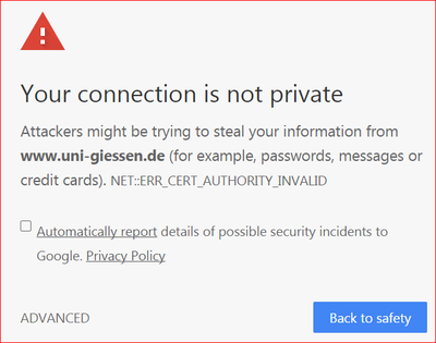

06/06/2017 11:44 AM
P.S. My browser gave a stern warning when trying to access that site:
