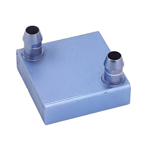

Hello everyone,
I'm looking for a metal or alloy that I can use to improve a school project that can transfer cold, below is quick overview of the project:
So the project is a wine cooler that can keep a specific temperature that is programmed into a temp. controller that is wired up to a TEC. So I need a metal or alloy that I can get machined that will transfer the cold to the inside of the cooler while attached to the TEC. I got it work using an aluminum recessed lighting housing wrapped in aerogel so that cold would not escape, but now i'm looking to improve it so that it can get colder and stay colder for longer. I would appreciate and suggestions or comments, thank you.

Look at the thermal conductivity of different metals in this table. Generally speaking your best conductors will be: Gold, Silver, Copper, Aluminum. What can you afford?
Do NOT forget a good thermally conductive paste. Again, there are different options, based upon your budget.

Thank you for the info. I do have a good thermo paste between the aluminum, TEC and heat sink. The table will work great.

Technical point - you can't transfer "cold", you can only transfer heat. To cool something, you remove the heat.
You need to find a metal with a high thermal conductivity (which also meets your mechanical and cost constraints). Google is your friend.

Aerogel is pretty expensive. Styrofoam is cheap and a very good heat insulator. Just sayin'.
As you probably know, the TEC is a heat pump. An important part of cooling is removing the heat from the hot side. A good finned aluminum heat sink connected to the hot side with thermal grease is essential, and if you can arrange for the fins to be immersed in a water bath to carry the heat away faster, that would help.

I never thought of immersing the heat sink in a water bath, What I am looking in to is those cooling system that are are water based or use coolant for CPU overclocking, kind of like a radiator on a smaller scale.

If you choose a water cooling solution, get some liquid that does not freeze, like glycol. That way you can have a clean closed circuit.

For serious heat transport, you could use a heat pipe. I don't know how expensive they are or what your budget is.
Another point - I assume you are driving your TEC with steady, not chopped DC. Heat pumped is proportional to the DC current, but heat generated (ohmic loss) is proportional to current squared. So the ratio of heat pumped to heat generated is best with steady current.
