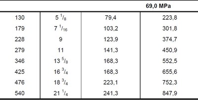

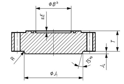

So for flanges up to 5-1/8" we have this
For blind flanges 5-1/8" and bigger we have
I know why the extrusion at the back of the small flanges is there, my question is why don't the flat backed blind flanges go down smaller than 5-1/8"? If it were because of pressure you'd assume it were the larger flanges which would need the support of more material.
