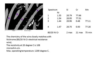

The said resistance was there in one MV drive ACS1000 in pre charging ciorcuit.
After it failed we found the following
A puncturing mark was observed on the resistance body indicating localised heating. On further analysis, small globules at wire tip at the point of puncture were also observed on magnification which indicates that the resistance wire has melted at the puncture point due to excessive localized heating & subsequently leading to pre-mature failure.
can we say that the resistance failed because of material defect
as wattage and operating conditions was found to be OK

Re: Nichrome Resistance Wire Globule Formation
07/18/2017 1:32 PM
With the limited information provided, I don't think you can reasonably narrow this down to defective material being most likely.
In the photo provided with the 'puncture' circled in red, just to the right of the circled area, there appears to be significant corrosion on the wire, as if something detrimental made contact with the Nichrome while it was hot.
The wire needs to be inspected to rule out pitting and other corrosions.
The break also strikes me as particularly jagged for something caused by a material defect which might have increased resistance over a portion of the cross section. The break suggests, to me, an initial crack that resulted in reduced cross section and subsequent localized over heating and failure.

07/19/2017 12:40 PM
Or the brittle vitreous resistor covering cracked as a result of wire failure and the extreme heat of the arc formed as the conductor with the microscopic inclusion or gas bubble parted...
07/19/2017 10:41 AM
I had a similar issue with a resistor set up to control phase angle going into a thyristor. The resistor was technically large enough for the intended current flow, but thermal cycling fractured ceramic coating on the power resistor and resulted in failure of the resistance wire. In that case, the solution was to go to an oversized wattage resistor by a factor of two and the failures of the ceramic due to thermal cycling went away.
07/25/2017 3:14 PM
JRaef writes that the life of these resistors is ~8000 cycles & maker is withdrawing support.
comments...
  1. This will almost certainly be a short-term rated component.
  2. Rate of temperature rise will be much higher than normal rating.
  3. Failure will be due stress on rapid heating eventually causing mechanical failure.
  4. Failure initiation is localised.
  5. You can stop turning drive on so often.
  6. Or replace failing resistor with several in series/parallel which have much higher current rating.
  7. Higher current rating will mean more resistor metal to reduce temperature rise & stress.
  8. "Electric firebar" type able to expand freely might be alternative.
  9. Space in drive/temperature may limit replacement options.
  10. Brutal approach of fitting well-rated resistors in external housing might be needed if you insist on turning drive on/off a lot.
