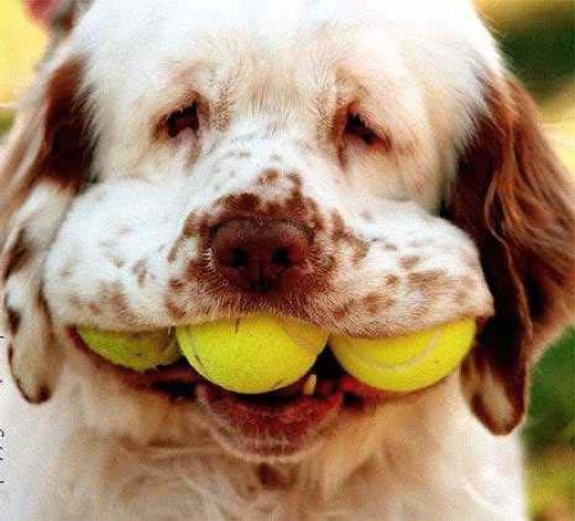

Previous in Forum: Khaaaaaaaannnn!!!   Next in Forum: Falcon Heavy to Launch in November
17 comments
Ace Fog, a Cooler Manufactured by Lunyee
07/27/2017 2:14 PM
i saw this video on YouTube, it quickly shows how to install an Ace Fog cooler. The video is in Chinese voiceover, script and English subtitles. The video is titled: how to install the air cooler , now I don't know Chinese, but maybe there isin't an English translation for : how to install the Ace Fog air cooler. Watch the video, provide your analysis of it's construction. The website is : lJianJi.com
Re: Ace Fog, a cooler manufactured by Lunyee
07/27/2017 4:28 PM
Why would you want to?
Re: Ace Fog, a cooler manufactured by Lunyee
07/27/2017 4:36 PM
Try sports misting machines....
http://www.bigfogg.com/sports-misting.html
Re: Ace Fog, a cooler manufactured by Lunyee
07/27/2017 7:13 PM
Let's try again.
Portal: YouTube.
Title : how to install the air cooler
The video starts with this image :
Re: Ace Fog, a cooler manufactured by Lunyee
07/27/2017 7:44 PM
From what I can see these are humidifiers....
https://acefog.en.ecplaza.net/products
Re: Ace Fog, a cooler manufactured by Lunyee
07/28/2017 8:52 AM
Yes, there are places where the humidity is too low, and nasal passages will dry out.
L.A. - I don't know for sure, Phoenix - definitely, El Paso - 100% too dry.
Controlled humidity inside the industrial process floor is important in cotton textile work, and some others.
Re: Ace Fog, a cooler manufactured by Lunyee
07/28/2017 12:30 PM
Yes but I think he wants to use it for cooling.....
Re: Ace Fog, a cooler manufactured by Lunyee
07/28/2017 1:39 PM
Obviously when the ambient humidity is about 20-30% in these arid locations, and can be lower still in some office spaces, a droplet evaporating humidifier should produce cooling to within a few degrees of the wet bulb temperature and that is pretty cool on a hot, dry day.
Re: Ace Fog, a cooler manufactured by Lunyee
07/28/2017 2:48 PM
Yes but are you installing a swamp cooler or a humidifier? These are both different from a misting cooler....They might all have evaporation in common, but they have different purposes and are designed differently....
https://www.culer.com/evaporative-cooling-vs-misting-fan/
Posts: 206
Re: Ace Fog, a cooler manufactured by Lunyee
07/28/2017 3:57 PM
If this "cooler" is working in a closed room; it would be just as if a normal refrigerator is kept working with its door open in that same room. Both shall not drop the temperature in that room at all! It can only work if the air-intake is from outside of the room and the room has a air outlet in the ceiling. Best results would be had if the air is dry.
Re: Ace Fog, a cooler manufactured by Lunyee
07/28/2017 4:19 PM
I held my "water" on this thread until now. I think the product is good as humidifier for controlled humidity if the room has a low to semi-low air exchange rate.
It is about worthless as a "cooler", IMHO.
Coolerado splits the air into system air (cooled without humidity addition), and working air that reaches near dew point (wet bulb closer), with a large change in humidity, and due to the design of the heat exchange media, the working outlet stream is warm humid air, and the system air is quite cool, with low humidity (if the room is low RH to start with).
Re: Ace Fog, a cooler manufactured by Lunyee
07/28/2017 4:19 PM
I see that this has been a blunder on my part in communication. I asked that members would comment on the build quality of an Evaporative Cooler. Showing an image of the company website ( with the accompanying image of a mister ) has created confusion. So, in an effort to alleviate that, I showed an image from a YouTube video, in the vain attempt that the reader would watch said video and comment on the product being presented.
Re: Ace Fog, a cooler manufactured by Lunyee
07/28/2017 4:23 PM
Next time, put the link into the movie button above on the text editor bar.
Re: Ace Fog, a cooler manufactured by Lunyee
07/28/2017 4:35 PM
What is a : movie button & a text editor bar ?
Honestly, I don't know what half of those icons ? images mean.
Starting from left to right. Bold, italic, ?,?,?,?,camera,video,?,?,?,?,?, x squared,Omega,happy face,?.
Re: Ace Fog, a cooler manufactured by Lunyee
07/28/2017 4:50 PM
The one you said is video. You past the video URL into that, so when you have the video page open, just right click on it, and copy the video URL, or video URL at the point in time, and paste it into the video button page on CR4.
Don't worry. The old guard had to teach me how also.
Re: Ace Fog, a cooler manufactured by Lunyee
07/29/2017 1:56 PM
See now not even you can find it again....
Look in the history on your browser....not bowser...
Re: Ace Fog, a cooler manufactured by Lunyee
07/31/2017 12:05 PM
OK, typo city. You got me on that one, nice pun bowser.
Re: Ace Fog, a cooler manufactured by Lunyee
07/28/2017 4:25 PM
Well we'll need a link for that.....
Register to Reply 17 comments
James Stewart (7); jurie sa (1); SolarEagle (6); tonyhemet (3)
Previous in Forum: Khaaaaaaaannnn!!!   Next in Forum: Falcon Heavy to Launch in November
