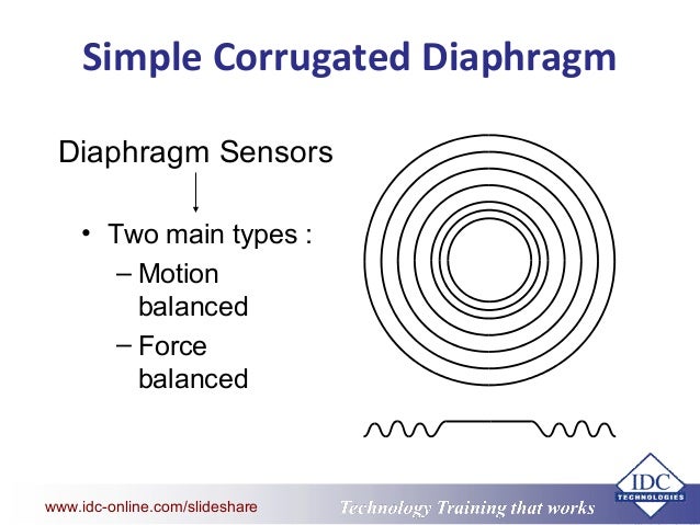

good day,
i just want to ask how is corrugated diaphragm permit larger elasticity and deflection compared to flat diaphragm and how does its structure protects from overpressure its just that i cant get the proper explanation in this one from my sources
thank you in advance

Corrugated diaphragms permit considerably larger deflections than flat diaphragms because the corrugations increase the effect length of gauge element.

It's pretty easy to push an accordion bellows a few inches to one side, but not so easy to push a violin string that far.

..."Diaphragm elements basically possess a corrugated profile. A smooth metal diaphragm would deform plastically under loading and would therefore make a precise pressure measurement impossible."...
http://www.instrumentation.co.za/8522a
..."Measuring systems with diaphragm elements, on the grounds of their design alone, offer good protection from overpressure, since the diaphragm can support itself against the upper flange. "...

When the diaphragm deflects, the span across it has to increase. The corrugations allow the diaphragm to stretch and thus deflect further.

The corrugations result in a much larger area and effective diameter of sheet metal that is under pressure stress. Such a larger diameter allows a much greater deflection of the center of the diaphragm for a given internal pressure. Stops (rigid "snubbers") are attached to the supporting framework that stop the diaphragm movement beyond a predetermined deflection.
