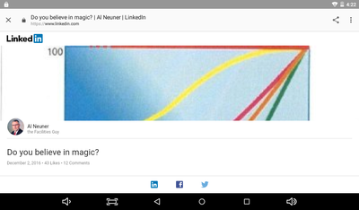

In many applications, a VFD is suppose to help the efficiency of a factory/building. If this is true, then is this some sort of magic device? We know that it's lossy, so how does it increase efficiency. Here's your answer: http://www.ecmweb.com/harmonics/4-1-1-variable-frequency-drives

Auto broker:
According to this guy, vfd is a magical device.

The naysayers are usually objecting to what are actually false claims made by overly zealous sales people. VFDs do save very significant energy in SOME SPECIFIC SPPLICATIONS and those savings are documentable. But there is no magic involved for sure. Very simply, VFDs only save energy by allowing flow control in centrifugal machines where energy is wasted by some other means of flow control. That's because in reducing pump/fan speed to reduce flow, the energy reduces faster than it does with mechanical means of flow restriction due to the Affinity Laws. Even then, not every situation will result in energy savings, it needs to be properly studied.
Anything other than that and all you are really doing is reducing work preformed, meaning that even though less energy is used, more time is consumed so the energy per unit of work accomplished is constant.
