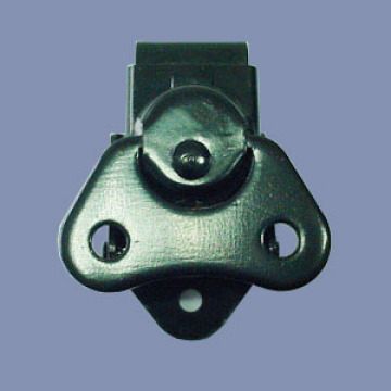

Hello :) (sorry for the bad english, but I really am in need of help)
I currently attend a mechanical school in Austria and have to design a new clamping unit for a lid.
The circular lid is loaded with a force of 60kN (the force acts on the center) and clamped with 4 units.
The currently existing units are equipped with star-shaped grips which have to be turned clockwise to clamp the lid.
The problem here is the particle generation of the thread.
Therefore, i am looking for another solution, which can applie the force needed to clamp the lid, but without the particle generation.
It has to be a manually operated solution.
I am thankful for every kind of advice you can give me and am thankful for you spending your time helping me.

These clamps should work ....

Firstly, thank you for replying to my post, i really am grateful
Could you tell me the name of these clamps or perhaps message me a link of them
Thank you
Re: Clamping Unit Needed
08/28/2017 10:37 AM
Over center latches, draw latches and other names.
Simply hover your cursor over the pictures and click your mouse and all the information is linked to the photographs.
Good luck.
08/28/2017 12:25 PM
Oh, my!!!! Guess I am amused because I know what those clamps are.
08/28/2017 12:46 PM
OP said, "have to design a new clamping unit for a lid."
I was merely providing a concept that he can scale up or not. Picky, picky, picky.
08/28/2017 3:26 PM
I meant to reply to #3. Those are not clamps for a lid........
Unfortunately because of one the ex-wife's brilliant web store ideas (failed), I know exactly what those are.

You are right that these would probably better, but i was tasked with finding a clamping unit that can be manually operated

I presume the 60 kN force is NOT applied until after the lid is in place. Is that correct?
How big is the lid? Does it need to resist corrosion? High temperature?
I assume that by particle generation, you are referring to thread wear. Is that wear occurring on the bolt, the nut (star-shaped grip), or both? Perhaps, as someone else hinted, the problem is not with the design, but with the material(s) chosen for the bolt and nut, or the heat treatment of those materials.
Since this clamping system only has to exert force in a single direction, consider changing to a buttress thread form, and perhaps lubricating those threads.
Take a look at several pressure cookers for additional ideas.

Hello and thank you for spending your time helping me
The lid has a diameter of 320 mm
There is no high temperature in the process and it's all happening in a cleanroom so corrosion is hardly a problem
You are right about the particle generation, it's the thread wear. The particle generation is occuring on the nut, at least, that´s what I was told.

JStewart correctly converted the 60kN to close to 13,500 pounds, which means over a ton and a half of tension on each bolt. I also agree with him that there ought to be more than 4 clamps!
Now I'm beginning to think the problem may not be the device, but rather the procedure. If the threads are wearing sufficiently to create visible particles, then those clamp nuts must currently be moved while the unit is under pressure. If so, why? I sure as heck wouldn't want to fiddle with them with that kind of force applied.
There may be something I haven't thought of, but I can't imagine a reason for adjusting those clamps while under pressure. The pressure should always be released before loosening those clamps, and should not be applied before they are tightened appropriately.
I have no idea how your instructor might react to the above concept, since your assignment was to change the design, but a good engineer should always consider alternative methods of solving a problem.
