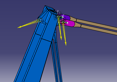

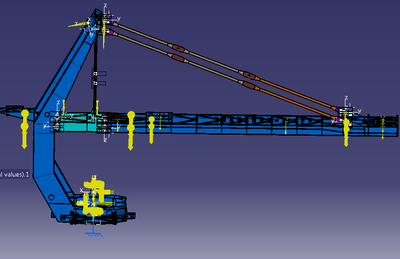

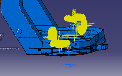

Hi there,
I am working on my master work about counterweight boom analysis on a stacker ARs2000, and i wonder if someone from here could help me. Can someone suggest me, how to make simplified mechanic (analitic) model of a model in a attachemnt picture. So i have a console at the botom of platform, and some forces and small moments from main boom on the platform. Also at the and of counterweight boom i have counterweight force, and a force of hidrocylinder at the top. I have joint connection at the middle part which is connecting central tower and counterweight boom, also at the guying stay. I want to check if reaction sensor Catia results are near to analitic model which i haven`t done yet?
Thank you very much,
Best regards.
Stefan

Analytic. Sorry for my not so good english. It`s like a free body diagram.

I already did that. I just want to make free body diagram of it, and calculate restraints on my own, to see if they match. This is an example, but not right example
beacose i assume the way i am doing it, it doesn`t make sense... :)

No, i think on simple physics analysis model.
