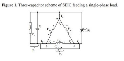

Hello guys. so I got a STS Heat Tracing system (skin effect) installed on a 15km pipeline carrying refined crude oil residuum. the heat trace itself is single phase 1570V. but it is supplied from a three phase transformer 415/1570V 50Hz. because the system is single phase, it uses a load balancer circuit to distributes and balances the current on all three phases (see poorly drawn circuit).
http://i66.tinypic.com/f9i6np.jpg
so now, the reactor L is damaged, completely burned. the capacitors are ok. my questions are:
- Has anyone seen this kind of circuit before? how does it work exactly?
- Can it be modified in anyway to make it work temporarily until we get the new reactor (the residuum will solidify inside the pipeline which is a huge problem).
- can I supply the load (STS) directly from two phases of the transformer (remove C1 and L)? assuming it can take the load, does using only 2 phases affect the transformer?
- can I use an old transformer as a reactor? connecting only one winding in the place of the reactor?
Thanks.

Here is a copy of your circuit. (You can paste pictures in with the little camera gizmo on the panel above.)
The three phases are 120 degrees apart. A capacitor can shift the current ahead by up to 90 degrees (ideally) and an inductor can shift the current back by up to 90 degrees (ideally) with respect to the voltage.
I haven't used this circuit, but I think the idea of this circuit is that the L2 current will be advanced by the capacitor and add to L1 and be retarded by the inductor and add to L3. Note that if the rotation of the source is not L1, L2, L3 this would not work. And, of course, the current is not shifted 120 degrees.

Here's another approach: If your load can be driven by DC, a 3 phase bridge could rectify the 3 phase AC and drive the load and be fully balanced.

It will work with 2 phases giving 1570 V AC. Rated transfo current = 150A, Heater 135 A. But check that the balancing is not to protect generators, which do not like unbalanced loads. It may be that the HV load is negligible compared to generator size anyhow.

I think I would disconnect the middle lead, then try to add some btu's....possibly you could speed the pump up a bit...maybe add an auxiliary portable heater midway down the pipeline....possibly you could raise the voltage a bit...

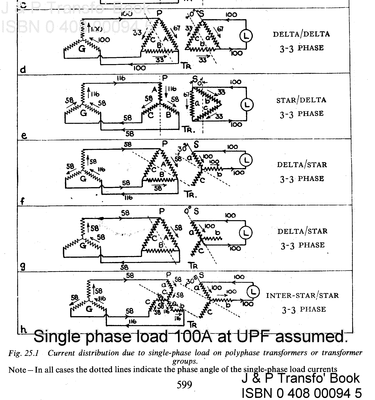

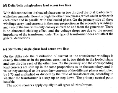

Can you please take a picture or scan the pages where from j&p transformer book where it explains unbalanced load.

Top of page left out as you have D-D type. Winding currents are amps for 100A load.

This is the text from J&P, first bit by character recognition was long winded, just did image for 2nd page - I left out winding configs probably not relevant.
(4) In considering the question of unbalanced loading it is easiest to treat the subject from the extreme standpoint of the supply to one single-phase load only, as any unbalanced three-phase load can be split up into a balanced three-phase one and one or two single-phase loads. As the conditions arising from the balanced three-phase load are those which would normally occur, it is only a question of superposing those arising from the single-phase load upon the normal conditions to obtain the sum total effects. For the purpose of this study it is only necessary to consider the more usual connections adopted for supplying three-phase and two-phase loads, as six-phase transformers which are used mainly for supplying rectifiers seldom supply unbalanced loads. The value of current distribution is based upon the assumption that the single-phase currents are not sufficient to distort the voltage phasor diagrams for the transformers or transformer banks. This assumption would approximate very closely to the truth in all cases where the primary and secondary currents in each
phase are balanced. In those cases, however, where the primary current on the loaded phase or phases has to return through phases unloaded on the secondary side, the distortion may be considerable, even with relatively small loads; this feature is very pronounced where three-phase shell-type transformers and banks of single-phase transformers are employed. Figures 25.11 25.2 and 25.3 show the current distribution on the primary and secondary sides of three- to three-phase transformers or banks with different arrangements of single-phase loading and different transformer connections, and in Scott-connected three- to two-phase groups with different arrangements of single-phase loads.
These diagrams may briefly be explained as follows:
So the "red flag"/"alarm bell" items are "shell type" & 3 ph bank made up of single phase units - which do not apply.

However, the issue here is whether the transfo or its supply system are overloaded, risking failure before plant is restored "as designed". Nothing you have posted suggests overload [rather losses much less than rated] and ambient & voltage are on safe side.
Even if you had an overload situation, you would assess by considering that each hour with 8 'C higher insulation temperature is equal to 2 hours of normal life - about 25 years for a transfo [to be clear 16'C would be 4 hours, halving of life for each 8'C higher] and whether that was significant enough to warrant flagging a reduced life on that transfo. You would take into account that the transformer normal load is less than rated & increase of life over "standard". The overload capacity of oil filled transfos is considerable and is utilised, in distribution, during life due to exception weather or loading where a lot of load is outside control of utility. You would also compare the risk of transfo failure (do you have a spare) & cost with the loss of production and restoration cost for the pipeline (the transfo cost is likely small change compared to pipeline).
As I wrote, if you want to worry, measure the currents/voltages including harmonics in each phase primary & secondary & put figures to transformer maker - or ask for their reaction (or heating system suppliers) to the effect of removing the reactor from the load. There may be an issue of management wanting to give business to Zenatrix here or acquire monitoring equipment/expertise as a long term facility - in which case, they should provide rationale & funding from strategic funds - not expect it from the maintenance/ "fire-fighting" end of operations

Thanks for transfo plate image. Note transfo is rated for 50'C ambient [and for specific height above sea level - corresponding to site?] & is to IEC60076 standard, usual for 50Hz.
The vector group [Schaltgruppe] had me puzzled for a while, because Dy6 is not physically possible - according to IEC60076, the capital letter is always the HV winding, regardless of whether it is primary or secondary [ the plate makes it clear 415V is primary].
Number 6 means "6 on clock face" referenced to "12 o'clock" source supply vector or 180 degree phase shift. On checking diagrams only Dz6 can give 180 degree phase shift ( similar Dz0, but polarity swapped on all windings on one side to make 180 degree change) which is a zig-zag winding on "star-like" side.
So the diagram that applies is "l" below with line-line 1 phase load....
Remember transformers are reversible - so source side on right does not alter current relations. Note that current on two lines on one side (zero in third) transfers to 2 line current on the other - the D-Y, D-D connections in post #22 always give current in 3 lines on source side. Load Current in only 2 lines on primary side matches your measurement of 522A on two phases.
The current in all the windings on D side is in phase with the dotted line (67 +33 = 100: note currents in B & C windings are same - zero line current at their join) so for...
Winding B, I lags V. - capacitor needed for compensation.
winding C, I leads V. - inductor needed for compensation.
The sum of the two compensation currents cause a current in the third line - I numbered it 2 to match your diagram, balancing the primary 415 volt load.
The Dz winding seems to be regarded as best for coping with a 2 line single phase load on a 3 phase system.
I am sure that the designers of the heater system made sure that the system would still work, to give maximum availability of pipe heating, if the inductor or/and capacitor connected to "2" terminal were disconnected.
