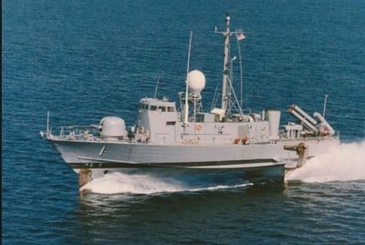

Re: Better Balance of Ships in Wavy Seas
10/01/2017 5:06 PM
BS. Use subfoils and get a propulsion to get it above the waterline.
10/01/2017 9:58 PM
Ah, yes, that works too, lift instead of buoyancy!
Join Date: Feb 2017
Posts: 12
10/03/2017 6:43 AM
Please, we're talking big commercial ships.
10/03/2017 12:01 PM
Are you stating unequivocally that no large commercial ships use any form of hydrofoil? Just asking...
