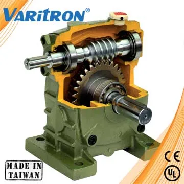

I thinking that maybe a worm gear drive is the way to go.....A DC motor with an encoder, when the power goes off it stops almost immediately....high torque start, fast stop, simple, strong...
