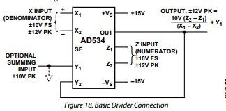

I need my analog brain trust. As P/O a project I need to determine the duty cycle of a PWM signal. This signal will have frequency of 10hz to 100hz and duty cycle of 2% to 40%, both parameters constantly changing. And I need an output that has no ripple and no latency; i.e., it will reflect the duty cycle of the PWM as of the last pulse. I have come up with this insanely complicated circuit:
The PWM signal has it's 1 and 0 times converted to voltages (see pulse width to V).
These are added by op amp to get the period. Then a voltage divider (AD539 or similar) divides the input pulse by the period to yield the duty cycle.
1) Can you find problem(s) with this circuit?
2) Is there an easier way, given the strict output rqmnts? I really want to stay away from microprocessors and software. The last program I wrote was in Fortran..

It looks like it could work...v1 is the high time, v2 the low time + high time, v0 = v1/v2.
Your "pulse width to voltage" blocks would be integrators with a fixed voltage input. Select a voltage so that the integrator does not max out at the lowest frequency (longest period). You need 2 integrators, one fed with an inverting signal as shown.
There are a few things to consider. You want it to work continuously, so the output of each integrator needs to be stored until the end of the cycle, and each integrator needs to be reset for the next cycle.
So you need some logic so that when the input is high, it is integrating. When the input drops low, the output is latched and then the integrator is reset. I would drive a capacitor on the output of the integrator. Put a CMOS switch between the integrator and capacitor. Opening this switch will latch the voltage on the output capacitor (sample and hold).
Sample and Hold:
Another CMOS switch in parallel with the feedback capacitor of the integrator can be turned on to reset the integrator. (Delayed slightly after sample and hold)
One integrator is integrating while the other is reset allowing this thing to operate continuously.
http://www.learningaboutelectronics.com/Articles/4066-quad-bilateral-switch-circuit.php
To get the voltage ratio, I would use the AD534 which will give you the ratio of two voltages with the right connection:
http://www.analog.com/media/en/technical-documentation/data-sheets/AD534.pdf
I hope this helps. I think it will work. Please let us know how it comes out!

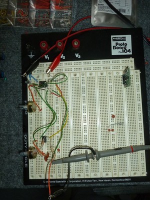

Thanks for the considered response, Rixter. I've built a slick PWM generator with variable duty cycle and frequency (see PWM generator) to test my design. AD has a bunch of chips that do voltage division; AD633 is only $11, but needs an op amp. AD539 is a little cheaper than AD534, but both seem to do the job. If no one finds a problem with my design I'll build the circuit and post results.

Is there anything so satisfying as breadboarding a circuit and seeing it work? Well, yes, but they all involve naughty stuff. Here's my PWM generator:
I bought a couple of these "proto boards" many years ago, and have gotten good use of them.

That's the same breadboard I have. I built +5 V and +/- 12 V power supplies in a metal box and mounted the breadboard on top.
I used to use a slit-n-wrap (184-1) to wirewrap a circuit after I had it perfected, using wirewrap IC sockets and wirewrap pins for the discrete components. You can wire multiple pins together with a continuous wire run with the slit-n-wrap, which reduces the effort of building a circuit.

I've used all three analog ratio chips and there is one inherent problem with them. They become unstable and oscillate when the denominator approaches zero. Be very careful with the circuitry for the denominator to prevent this.
Speaking of the denominator circuitry, if you don't change the input polarity to the op amp that generates V2 then this output will always sit at the positive rail, information will be lost. If you swap polarities then V2=k(Vpwp+Vpwn). {Voltage Pulse Width Positive -> Vpwp, k is the combined transfer function of pulse width to voltage and the feedback resistor}
Re: Precise Duty Cycle of PWM
11/04/2017 7:39 AM
Notice in your link that the feedback resistor connects the output to the inverting (-) pin and a fourth resistor is also connected from the inverting pin to ground. Your sketch has the inverting pin directly connected to ground.
