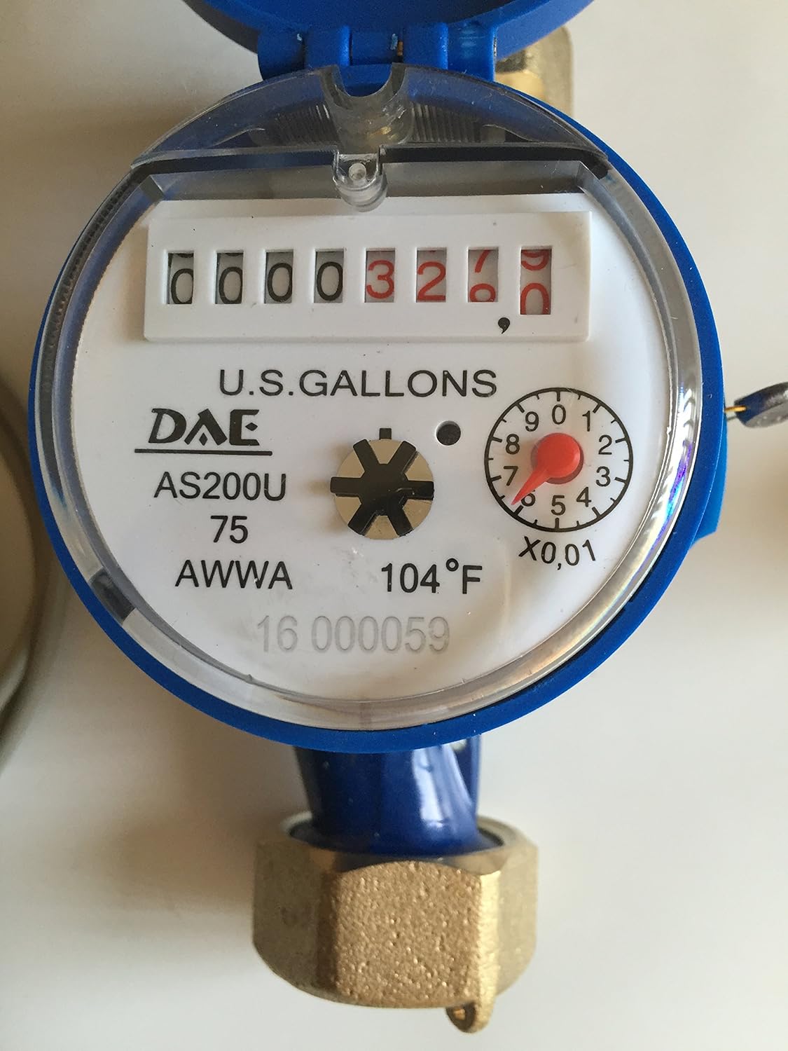

Hey Gang, I have a problem looking for a solution. I have a production lab that is currently using 5L pitchers to fill mixing containers up to 100L. obviously time consuming and not a highly traceable method of ensuring correct volume.
Our facility is working to meet Pharma requirements in our production processes. The pitcher method does not meet that criteria.Volume graduations on the containers are not accurate to the required level either causing repeatability issues.
What I am researching are flow meters that are capable of measuring standard tap water with a +/- 1% repeatable tolerance over a 100L fill. Being able to "set" the dispense volume, turn it on and forget it is ideal. Cost is a factor also. Anyone have any experiences or trusted suppliers they can recommend?

-Micro Motion (Emerson) Coriolis mass flow meter; these things can measure/calculate mass, volume, density, temperature and flow rate. I find them to be among the most accurate flow meters, easily set up with a solenoid system to run preset volumes- I have one on an automated system that doses unattended. Very reliable but $$$$$! More conventional type would be less $ and less accurate but still will meet your need- note you still have to integrate them with a control system to run the solenoids. I agree with Lyn's choices.

As Lyn suggested in #1, Rosemount or other water meter suppliers should be suited.
"Domestic" water meters (dial type) that we install for reticulation are guaranteed +/- 2% when new.
We have a few electronic ones (Reset when close cover) that we use for calibration at +/-0.2% at around $500 AUD.
We also have a calibrated (traceable certificate similar to USA NIST) at around $7k. (Probably 2k for meter and 5k for lab fees)
