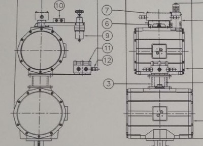

Recently I learned about tandem actuator. Is there is any tandem actuator for rack and pinion type?is there is any possible way to couple the two rack & pinion to get more torque under the tandem principle?
I have come across a drawing of my competitor he had implemented the same principle on a normal rack and pinion type by one above the other how it is possible.
Kindly share the lecturer or some information on this.

Have you considered scotch yoke type actuator? Can give higher torque at valve disc break-out, which might be all you need. Plenty of data on the web.

Thanks for your reply, but scotch and yoke actuator is a costlier option and we can't afford those for a price competitive market like India. That's the reason we are looking for this option.

You are looking for a Rotork RHQ actuator. It uses double acting parallel cylinders and a rack an pinion drive.
