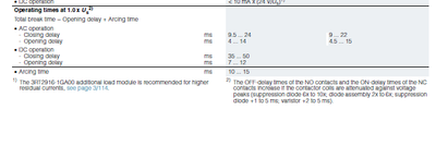

As example, following is from Siemens 3RT contactor catalog, the time to close contacts after applying AC to coil.....
There is a large spead of times, 9 to 22 ms (partly because voltage of sine wave at instant of connection can be zero to peak) - your contactor would be selected on its minimum time.
