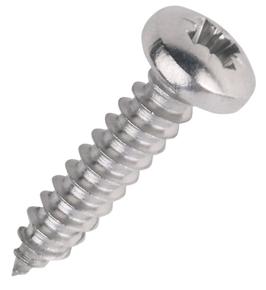

I have a tiny bottle of perfume (around an inch wide and a little more than that high) with an equally-tiny broken stopper. The stopper consists, or consisted, of a short horizontal bar attached to a plastic thingy that goes into the neck of the bottle. The bar broke off, leaving the plastic behind.
Any ideas on how to get the plastic thing out (without spilling the contents)? I tried a needle-nose tweezer and got nowhere. The stopper is about 1/8" in diameter and has a small indentation in the center. The picture probably isn't much help but including it FWIW.

If it's plastic you can drill a small hole and insert an easy out, or even a small screw....or maybe just submerge it in hot water, like boiling hot...but you might lose the contents that way....

1/8" ? That's pretty small.
I'd suggest using the sheet metal or wood screw just like a cork screw. Don't drill the cap out.
If all else fails, push the stopper through the neck and re-bottle into another container.

Any short piece of solid wire (like piano wire) makes a fine drill bit for drilling through oak or tiny plastic stoppers.
Combining some tips from above.. I think the smallest hole with the tip of a long thin screw heated hot then pushed in and turned a bit would grab nice.
Test on the broken T bar part any method you consider.

Whatever you do, don't use any screw with a tapered thread. The act of tightening the screw will expand the stopper material making it even tighter in the neck of the container.
If i had this problem, I would get the thinnest round needle file that I could find, use the Dremel tool to drill a slightly oversized hole, then use crazy glue to bond the file to the stopper material. The machined surface of the file provides a bit of extra grip for the glue, and if you're so motivated, you could drill a matching hole in the T-bar, add some more crazy glue, and fasten the T-bar (almost) back into its original position.

All the needle files I'm familiar with are hardened all the way through, so very brittle, and likely to break.
I would use a tapered screw (well under the size of the stopper), and I'd drill the undersized hole, but I'd hold the screw in a screwdriver that has some way of gripping the screw, heat the screw until it is hot enough to melt the plastic, then screw the screw into the hole quickly until it cools to the point that it does not easily melt the plastic. Let it cool completely, then wiggle the screw around and around 'till the stopper loosens. The longer the screw, the better! A 2-3" deck screw would be great, if you can find one small enough.

What about a tiny eye screw:-
Drill a hole in the stopper which is very nearly the outer diameter of the thread, but, not all the way through; put a drop of epoxy (araldite?) in the hole with a cocktail stick, and, screw in the "new" handle; don't allow any glue to flow to the junction between the stopper and the bottle; let it set.
