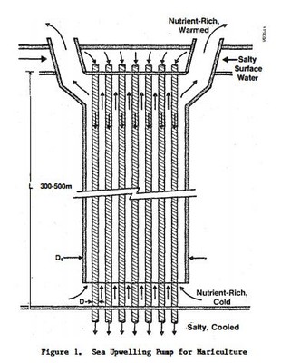

Actually, there is a phenomenon called "The perpetual salt fountain" that requires no external energy. Here's how it works:
The density of seawater is determined by two factors, the salinity and temperature. On the surface where evaporation takes place, salinity is higher causing an increase in density. Also, on the surface, the ocean is warmed by the sun causing the density to decrease. These counteracting effects result in an equilibrium temperature and salinity gradient.
Plot of temperature and salinity in the Arctic Ocean at 85,18 north and 117,28 east dated Jan. 1st 2010.[1]
https://en.wikipedia.org/wiki/Halocline
If a heat conducting pipe is lowered into the ocean and flow is initiated, then water will continue to flow. If water is flowing downward the water will be heavier inside the pipe due to increased salinity (the pipe prevents mixing with surrounding water). If water flow is initiated upward, the water inside will be lighter due to the decreased salinity. It works because the pipe allows heat exchange with surrounding water but not salinity exchange.
"An Artificial Upwelling Driven by Salinity Differences in the Ocean"
https://www.nrel.gov/docs/legosti/old/2149.pdf
https://link.springer.com/article/10.1023/B:JOCE.0000038349.56399.09
I don't know if this is practical, but it is interesting...

Re: Self-Sustained Water Pump
05/15/2018 3:27 PM
".... If water is flowing downward the water will be heavier inside the pipe due to increased salinity (the pipe prevents mixing with surrounding water). If water flow is initiated upward, the water inside will be lighter due to the decreased salinity. ..."
...er...what? If there is no mixing through the pipe wall or other exchange, how is the salinity changing?
Also, the chart provided shows only a very small inversion just under the surface of the larger overall salinity gradient. Inceasing salinity with depth should serve to stabilize the picnocline, not provide opportunities for unpowered mixing.
What am I missing here?
Location: Thailand
Posts: 631
05/16/2018 12:28 PM
The salinity at the top is higher (i.e. denser), due to evaporation - so, once flow downwards is initiated, it will continue.
Likewise, vice versa-
(Theoretically, however. I wonder what is the min height difference for a 'worthwhile' flow?)
05/17/2018 8:25 AM
From the charge provided, there looks to be less than a 0.1 PSU difference between the salinity shown at the most shallow point and the point of least salinity. That point of least salinity appears to occur at a depth of about 35m . The chart begins to indicate salinity around 10m. with no indication closer to the surface. Below about 35m salinity increases markedly and becomes higher than any salinity indicated for shallower depths by about 40m.
There does not appear (from the chart provided) to be a salinity gradient favorable to sustained natural circulation below about 35m. Perhaps during summer months the salinity near the surface is much greater due to carrying away much surface water. The chart though is from the middle of winter which is probably why the temperatures near the surface are below those anywhere else in the column.
I bet there are regularly conditions at certain places at certain times of year where this type of scheme could work between the surface and certain depths. There might even exist some places where this type of scheme could work between the surface and some depth more days of the year than it wouldn't.
Has this been implemented successfully anywhere yet? Kudos if it has. Best wishes to anyone who is en route to such implementation. To me, the differences attempting to be leveraged are too small and the places where those differences occur too variable for any prospective gains to ever justify the likely costs.
05/18/2018 3:52 PM
You are exactly correct. (Good eye, and thanks for keeping me honest. )
The plot I included was from the Arctic Ocean, and is a bad example. Unfortunately, the Baltic Sea, I suspect, would be similar.
In the tropics, the salinity should be greater on the surface due to evaporation and the temperature should be warmer due to solar heating. In the polar regions, there is not much solar heating and the salinity is apparently lowered, I suspect, due to fresh water from ice melting.
Here are typical profiles for tropical regions where the perpetual salt fountain might work. AFAIK, nobody has actually built one, but the process occurs naturally and is known as "Salt Fingering".
https://en.wikipedia.org/wiki/Salt_fingering
http://www.hurricanescience.org/science/basic/water/
So, you are correct, not practical for polar regions.
