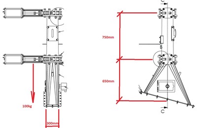

Dear All,
I have one question that is bothering me. Regarding choosing the appropriate thickness of sheet metal for the below construction.
I am not sure or to choose between 3mm or 5mm thickness. The material is S235JR (1.0037). Below is a picture of the construction. Both valves have a weight in total of 100kg
Could somebody give me some suggestion which thickness of sheet metal should I choose?
Thank you very much for your reply

When in doubt, build it stout.
5mm.
Re: Sheet metal thickness
06/11/2018 5:51 PM
I have to agree, 5mm for me.

This depends on the design load of the constructed item, the material being transported and design life target...Why is it between 3 and 5 mm? You must have had some criteria to consider in making the judgement...

with the information giving and with the overhung loads 5mm looks to be better suited... is it going to be supported on both other ends?
also, I'd be concerned about the rectangular flange thickness also.

Is there flow going through that contraption?
What is the environment this is in? How much allowance for corrosion is there?
5 mm maybe not enough!

Its modelled in 3D. Can you run a FEA?

That would be the best thing to do as it appears not to be just your ordinary shape. Also, factor in any live loads (material moving, valves operating) that may happen along with the dead load already given. No idea of how often the valves will cycle either, so, if in constant use, there may be a possibility of fatigue as well which would affect material grade and thickness.

How many are going to be built?
Is the "production" cost difference between 3mm and 5mm going to be significant.

The sheet metal needs to be strong enough to keep form from the vacuum inside the duct.There should be structural members such as extruded aluminium or angle iron to support the weight of the valves ect.
I do not understand why this has not been addressed?

220lbs, The 3mm should work just fine, that's equivalent to 10 gauge, that's plenty.

What I always say in this type of question is firstly start with a free body diagram for all the load cases you can see this will experience. From that you'll get an understanding of where the critical areas are and you can then simplify the geometry to enable you to do hand calculations (bending, torsion, shear....whatever).
You can then compare these results with whatever allowable stresses, strains etc. you derive from whatever standard you choose to use. If it is acceptable then that is it, if it fails you can either redesign it or choose to do FEA, in most instances if your hand calcs show a marginal fail, FEA will show a pass as it is less conservative (in general).
Then after you have done that and someone questions why you designed it that way you can show a logical design process which, with the information you had at the time, led you to choose that design. Or you could just ask here and we'll all tell you random answers!

you must count the volume of your sheetmetal base.
And do distribute the total load to your volume of cone (exclude the base plate).
find the yield strength of S235JR with 3mm plate from standard data from any engineering book or reference. If it is more ...you are safe.

Can you confirm how you came to this conclusion? Firstly why are you calculating a volume? What stress are you trying to calculate?
Next, you are applying what load to this volume? Is this load in compression, tension, shear?
The yield strength of the material is the same regardless of how thick the plate is.
And would you not want to work to a recognised standard which perhaps has allowables? I know in my job I can't justify designing something up to yield strength.
