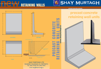

Re: Retaining Wall
06/28/2018 8:20 AM
Probably local enough to you... shay murtagh... Mulingar
https://www.shaymurtagh.co.uk/wp-content/uploads/2009/06/retaining_walls.pdf
