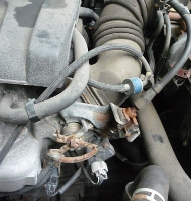

I work on my car from time to time mostly when it has issues. I have had one intermittent issue since I got my car a few years ago that I kept putting off looking into. When I finally looked into it the solution turned out to be a simple one.
The problem
The problem happens when it is hot out and the car is hot and I drive the car and park for about half an hour or less. When I start the car after sitting for a short time and the engine is hot, the idle is high, sometimes 2k but sometimes 3k. Another seemingly related issue I was noticing, when I come off the clutch the engine speed would dip before it settled and in rare cases stall. The issue didn't happen when the weather is cold and not when the engine is cool. If the car sits for an hour or more so that it cools down some then the idle is fine.

I decided I was time to fix the issue. The problem hadn't happened in a while as it was cold out. On one of the first hot days of the year I decided to bring in my car for inspection as it was due. It passed inspection, but I noticed the person who pulled my car out of the bay looking confused and talking to the others after. No one said anything to me about something being off, I got in my car and when I started it, it was idling at 3k which is quite high. It was one of those rare moments of a hot day and the car was only off for a short time for the inspection. No CEL or codes presented or it would not have passed.

As it so happened the light telling me it was time for an oil change came on. knowing that is a quick easy job I picked up the oil and filter to do that after work. I opened the hood with the engine still hot and looked at the throttle body. Upon inspection, it looked like the throttle was not sitting on the idle adjustment screw. I pushed the valve and sure enough their was a gap and the cable was pulling tension. I changed my oil and then went out later after the car had cooled and checked again. Now with the engine cold the throttle valve was sitting on the screw.
I turned the bolts
After a little WD40 I turned the bolts holding the cable sheath, it only took a small amount of adjustment to remove the tension. It took all of 10 minutes and would have been quicker if it wasn't a bit rusted.
The result
The idle is now perfect and stable with no dips or revving. It has been a little over a week and we are going through a heat wave. I have had to run a number of errands and left my car sit hot and started it again a number of times already. Every time the idle is just below 1k where it should be. I also don't see it dip low when I come off the clutch. I am guessing that issue was the computer trying to compensate for a mechanical issue. The problem as best I can tell was that the cable sheath expands and pulls tension when it is hot.

From the looks of that photo, I'd say you have a serious rust problem.
I'd suggest a monthly spritz of WD-40 from now on.

Rust problem? Where? That ain't no stinking rust. It's just a bit of patina. You Arizona folks get so spoiled cause nuttin' rusts down there.

I read it as the purpose of the WD40 was to free up some rusted bolts.

Yes the WD40 was to free the rusted adjustment bolts, the throttle body moves freely. If the butterfly valve was sticking I would have removed the throttle body and cleaned it completely.
