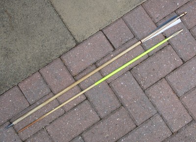

Flight arrows are V skinny, V light with tiny flights designed for maximum distance rather than penetrating armour
Here's a pic for comparison... the flight arrow is painted bright yellow so you can find it when it's gone 320yards !
