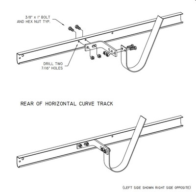

Problem:
20 foot door was rolled up and did not stop till it ran off the top of the track.
Using non-OSHA approved lift we managed to get the door back into the track and operating properly, for now.
Isn't there supposed to be a stop at the top of the travel to prevent this from happening? Is there a fix, or do I need to call George, the doorman?

If it's an electric drive, there should be limit switches in the control box for upper and lower stops. At least that is how my doors are set up.
If it's manual then I am not sure how it is supposed to stop except for stop pulling on the darn chain.
If there is an angle at the bottom of the door you could put stops on the top of the track to prevent it from going farther up.

Hey guys, sorry I’m late.
That’s a rolling or coiling service door. There should be (can’t see in the pic) a bell shaped guide at the top of each track (bellmouth guide). These keep the slats lined up in the track when the door is rolled down, and stops the two angle iron bottom bar from going past.
These bell guides can get loose and fall off, that is my guess here.

The edit system is a bit buggy. Trying to take advantage of the extended edit time, said I had 8 minutes left - cool! A minute or two of editing, submit... sorry, out of time.
Anyway, an image of the suspect piece can be seen in step 22 of these general instructions:

Mystery solved; door fixed.
It was some $20.00 doohickey at the top. Probably that bell thing like Doorman said.
