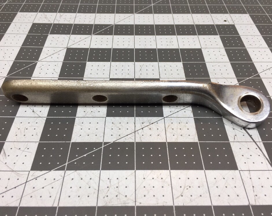

Another thing I need to find out is with the armrest bracket on the left armrest where it connects to the backrest of the chair is broken. Can it be welded to restore it?

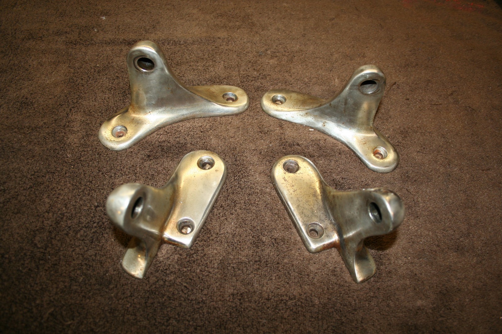

Well, after doing a lot more searching, I found that my chair doesn't use the butterfly style lock. It looks like it's very similar to the oblong piston brake for Paidar chairs, only instead of being 2 inches long, the space for the lock is only an inch long.
I did some more searching and found one. i have ordered it and am waiting for it to arrive. Now all I have to do is figure out if the 1406 armrest bracket can be fixed via welding or if I can find one online to replace the broken one I have.
Here are a couple pictures of the part as it should look and how it broke.
