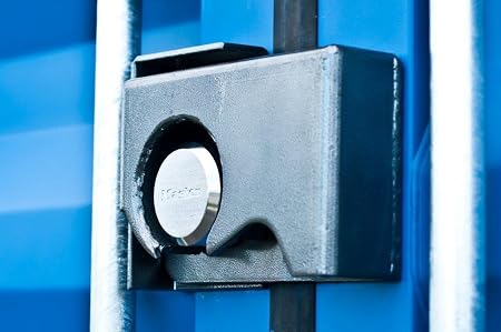

I should have been more descriptive , I’m looking for ISO shipping container [conex] horizontal solid ,side twist lock adapter to bolt something to side of conex bottom corner block . I’m Having trouble trying to paste picture in forum

You're trying to bolt something(?) to this piece?
Something like this?
Is this to connect the container to the deck, or to another container, or for some other purpose?

Yes to Solar Eagle . Trying to bolt roller to side of corner block pictured in your comment
What is your weight limit? Do you have rollers already? ...or do you need the whole assembly?....just wheels or towing?

Looks like bottom of page 3 where containers are bolted to concretehttp://www.containerhoardings.com.au/Shipping-Container-Connections-Parts-Catalogue-18-08-2016.pdf. I hope picture come thru

Ebay US $67.65
..."Side mounted twist locks are shipping container connection devices designed specifically to allow a shipping container to be bolted or welded to a footing after the shipping container has been placed into position. Our unique patented design is easily installed into the side hole of a shipping container corner casting, it has no moving parts, built from ZG 270/500 steel and is hot dipped galvanized."... Length 100mm Width 100mm...
I would maybe find a local fabricator....make up a drawing

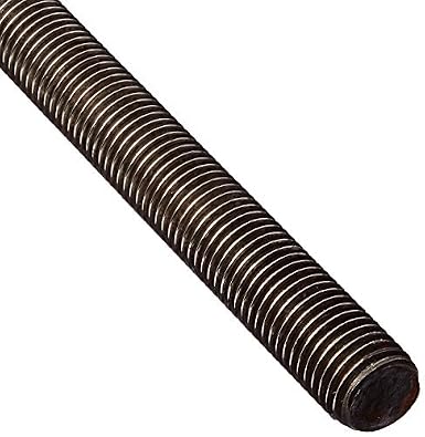

Just click on the picture...it's linked....I would just have the foot without the insert fabricated then just weld the bracket on to the container corner piece, make just the wheels removable...The insert is the tricky part....I would just weld some 1 inch all thread rod to the top of the castor assembly and bolt that to the foot....

I would just buy some 1/2" thick 4" square steel tube and cut it in 4" lengths, then cut it diagonally and weld in the side pieces and drill the hole, a fabrication shop could make these in no time...1 foot for 4 pieces...
2 ft for $100....enough for 8 pieces, or 2 containers....
