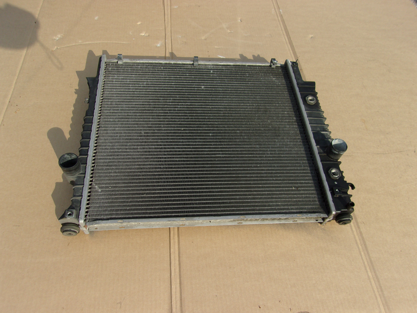

My wife bought her dream car sight unseen on Ebay. It's a 2000 Jaguar Vanden Plas with 94,000 miles. It's a Florida car, it's fast and pretty. I've had to replace the rear shocks, front and rear main crankshaft seals, the fuel pump, and just last week the water pump. Paying $340 to ship it to Ohio, we still have under $3000 in this car.
During the water pump and front seal repair, I removed the radiator, and now it leaks. The plastic tank on the right side has cracked and the local radiator shop says they can't fix it or find a replacement tank. A new MNC4190AH radiator for this car is $800 to $1725. The fact that it is hard to find and expensive when I do find it means they fail often and are in great demand. If I order it from the UK I can get it for $610 with shipping, but will this paper machete box survive shipping?
What would you do in this situation? Buy a Cavalier?

Depending on where specifically the tank is leaking, you may be able to effect a DIY repair.
The plastic tank is probably a glass filled thermoplastic, injection molded part.
If it is a seam, and is joined to a brass of metal part, a picture would be nice.
Pressures on the order of 15 PSI are normal and not too high, but differential expansion rates need to be considered since it gets hot, then cools.
Depending on the urgency of the repair it's a thought.
I have some practical experience with this sort of thing, and there are a few others here who do as well.
If you want to pursue that, get back to the forum, or PM me with more details and a pic or two.

Brave Sir Robin: Woody's has had the radiator for 8 days, and he now tells me he's sold the sheet metal brake to bend a metal tank. (Which I would have preferred). I will call around and see if I can get brass end caps made for the aluminum center.
Solar Eagle: I have been soldering since I was a pup, I think I shall give this a try, the only tools I don't have are the radiator repair kit and the tear drop shaped wood cutter. I also have an ancient giant soldering iron type tool used for tire tread cutting. Nice videos too. Preheating before welding makes me think of cast iron repairs on the old 8N and 860 Ford tractors. I have started looking into Jaguar forums, but I have a hard time typing without an American accent
Lyn: I wish this had brass ends, I could already have it done (and polished). The core is aluminum, and the ends are thermoplastic, I just don't know what recipe.. I also have an old Stant radiator pressure tester, but need to adapt it to one of the hoses since radiator caps have evolved into threaded plastic configuration. It's leaking at the seam 1/3 of the way up on the right side, which is the hot side. The flow from the engine enters just above the leak. It starts leaking when I start the engine. Like I said previously, the radiator is still at the shop so no pictures yet.
I thank you all for the quick and informative replies!

Alec Ryals: I'm concerned about using an epoxy on the thermoplastic due to differing thermal expansion rates and the epoxy's ability to withstand the radiator temperatures. The datasheet states that it might work:
Q: How high of a temperature can Marine-Tex withstand?
A:Depends on pressure and conditions. Up to 250°F constant temperature in a dry environment, with spikes up to 300-325°F.
It may not be compatible: Q:What will Marine-Tex NOT stick to Plastics like polyethylene and polypropylene, and also any unclean, oily, greasy, or otherwise contaminated surface.
Redfred: 3D printing is out of the question, I don't have the equipment or a drawing I could supply to someone who does. What I need is a replicator like that sliding door apparatus on Star Trek.
I will probably try a warrantied used part I found 3 hours north of me (They also have the interior parts I need for the console and glove box door). I also want to try a repair on the existing unit just because I love to fix things.

I just received notice that my order of a new radiator has been "dispatched". It cost me £475.20. I should have it by Tuesday Oct 23. I'll get by Harbor Freight and check on a plastic welder this weekend.
