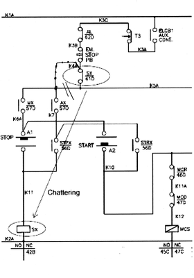

Consider the following circuit....
  1. The wire at the bottom, K2A, is negative supply - if there were an E/F there, it would be difficult to detect ; 4 mA could be 1% of load current, detecting such a difference in the currents between + & - supply would need high precision measurement. Of course, if voltage to earth were zero, it could be a direct short to the relatively few [compared to strings of contacts on positive side] wires/components connected direct to negative.
  2. If wire K11A on right were earthed, MX & AX contacts being open, then wires K10 & K6A would also be earthed - if contact open/close state is "as drawn". There would be a small, but measurable, voltage across coil MCS and voltage <K2A-Earth> would not be zero N.B. 4 mA x 50 ohms is 0.2V across MCS coil.
  3. With earth fault as 2, if K11A were linked to K1A by a test wire, then earth fault would move from negative pole to positive pole. Of course, this would energise coil MCS & one would have to ensure this did no harm or disconnect K12 from MCS first.
  4. In an in-service circuit, contacts may not be in "as drawn" state; however it should be possible to allow for this.
  5. Note that there are usually far fewer components connected direct to negative [and these have a significant resistance, like a coil], so a negative earth fault can be easier to localise, by measuring voltage across items like MCS - which should, no earth fault, have zero or supply voltage across them.
