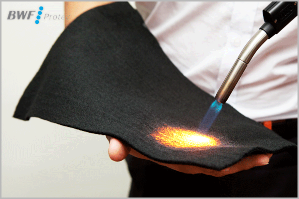

Re: Fire Protection
11/13/2018 5:05 PM
This stuff looks up to the task....
Fireproof building materials...

Re: Fire Protection
11/13/2018 6:25 PM
The fancy materials that would likely provide a good level of serious protection are still cost prohibitive though for a whole house?
