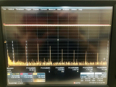

It would be very useful to see the emission waveform on the 'scope screen - this immediately shows if it is "near sinusoid waveform" with small harmonics of low number or a pulse which will have lots of harmonics (and possibly high peak value - EMC tests usually deal in peak values because interference is determined by that). Third harmonic value suggests high harmonics, but could just be a maximum value.
If that is a "digital oscilloscope" with A to D & software & USB connection to computer, there will be a way of downloading a picture of the screen, probably .bmp format, which can be converted to less megabyte files like .jpg or .png. This is my H field susceptibility test coil, taken with digital camera (1.4 MB) and converted to .png, 16 colour (674kB) - I used it to do the "iron shielding" tests I posted here. CR4 tends to reduce the size/resolution of images - if you give it too big a file, detail is poor in image. That is 100mm diameter, one turn, 2.5 sq.mm copper insulated, taken from house power cable. Yellow wire is 0.8 sq.mm, good for 12 amps continuous.
-78 dbm has variable meaning, unfortunately. Literally, it means 10 x logarithm to base 10 of ratio of measured volts to volts for 1 milliwatt in resistance R. R can be any value, but for telephone/radio frequency circuits 50, 75, 500 and 600 ohms are standards. One mW is approximately 0.25 volts rms in 50 ohm & 0.77V rms in 600 ohm. That makes your levels about 200 microvolt peak, 50 ohm.
What calibration levels do your emission probes claim?? e.g. xx Volts peak into yy ohms resistive at zz tesla peak sine @ 60Hz test.
Do you know what peak Tesla that -78dB means??
If your generator is 50 ohms, 10 volts peak, then short circuit is 0.2 amps peak. Have you measured the volts across probe with scope when driven by that generator??

the probe is 50 ohm input impedance, from Electro-metric. it is shielded.
i tried to make multi-turn coil to increase the H-filed emission, but still the filed is not strong enough with 10 V, p-p sin wave at 60 Hz, and when i used the pulse wave with 1 volt, it almost burn the wire.
the impedance of osciloscope is set to 50 ohm, so i can convert dBm to dbμv=107+dbm =>-78+107=29dbμv
based on calibration chart of scope at 60 Hz, this is equal 153dBpT, or -7 dBGauss

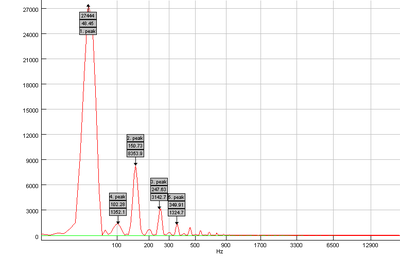

D/ Evaluation of Scope Frequency Spectrum Picture
The actual peak flux depends on the summing of the harmonics with correct phase as well as amplitude - is it possible for "scope" to give normal "voltage versus time" display rather than spectrum & post the waveform??
Third harmonic 180 Hz amplitude is 2 x fundamental - its true amplitude is 2/3 x fundament, since rate of change is 3 x at 180Hz. The 300Hz harmonic is even stronger. Such a level of harmonic distortion looks abnormal for 60 Hz transformer.

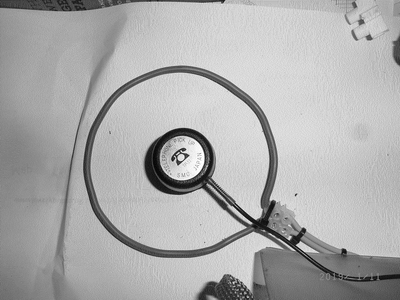

E/ Susceptibility Test Coil & Getting Stronger Test H Fields
Your coil, from size of "croc" clips in picture, appears to be about 4 cm long & 4 cm diameter with 25 turns. I estimate wire as 0.5 sq.mm copper, 3.2 m long, resistance 0.11 ohm @ 20'C. Inductance L = N2R/(22.86+25.4[L/R]) = 17 microHenry (N= turns, R= radius cm, L = length cm): reactance 6.4 milliohm@60Hz (negligible, compared to resistance).
Driven from 50 ohms resistive source @ 60 Hz ; it is a short circuit to source; 5V peak would put 5/50 = 0.1 amp peak into coil. You cannot assume output will not be distorted or "clipped" on such load.
I recommend you add 50 ohms resistor in series with coil (rated generator load) and measure coil current with your 50 ohm scope in parallel with 1.0 ohm metal film resistor as a shunt, between coil "bottom" and circuit common/ground. Current should be 0.05 amp peak. If you get twice amplitude & same sine current waveform without 50 ohm resistor in series with coil, you can be happy to use sig. gen on short circuit. Since it is 60 Hz sine, you can measure across the 1.0 ohm with an AC multimeter as a calibration cross check.
Field strength on & along axis at end of N turn solenoid coil R radius, L length (metres) carrying I amps, is μ0 IN/[2√(R2 + L2)]. With your sizes that is 350 μT per amp. With 0.1 amp peak as above, that is only 35 μT peak - or 17.5 with load made up to 50 ohm (0.05 amp peak).
You should measure with your several "H" receiver loops, coaxial at coil end, as a calibration check - specification is "loose" - it does not indicate how many turns "loops" have or if there is a resistive pad built into probe.

E) i added 50 ohm resistor to my coil in series, and used a signal generator with sin wave at each harmonic (60 hz, 180 hz, 300, 420, 540, 660,...) and generated magnetic filed close to the circuit (10 volt p-p). i don't see any effect at 60 and 180 Hz, i think because the signal is not strong enough, but at 300 hz and higher it works well as a source of localize noise injection.
i also measured the current pass through the coil with 50 ohm resistor using multimeter, it is 65.5 mA

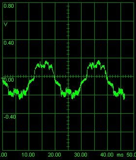

The scope picture looks like a short triangle pulse with a sloping rise followed by a step back to zero. Positive & negative pulse look identical. This would have a lot of harmonics (pulse length << period & step). I cannot read the scales, but I guess peak value is a lot more than any of harmonics in frequency spectrum (28 μV?) & frequency is 60 Hz.
What are the scales & peak amplitude??

D) the pick in time domain is 1.43 mV, and the scale is 2mV/div

D) Note 1.43 mV is 50 times the peak value of 28 μV for the fundamental. The spectrum measurement gives little idea of the peak value of real pick-up, except that harmonics to very numbers at uniform amplitude indicate a pulse. EMC test specs require sensitive narrow-band receivers, but oscilloscope time domain view gives a much more rapid impression of peak values & troublesome pulse type voltage (if the signal is enough to be detectable - a pre-amplifier is practical at low frequency & I noted a laptop computer has a 15 mV full-scale 16 bit D/A converter in post #19).

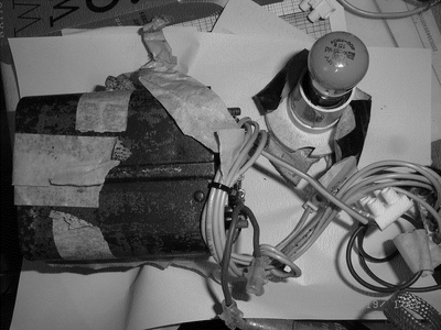

The above time domain & spectrum of "H" induced voltage at 3 cm from transfo I referenced earlier [posts #28 & #33] for steel plate shielding effect [taken with Laptop microphone (16 bit) input & Sigview display software]. As you can see, the wave looks distorted (it is actually "clipping" a little at peaks, it is hitting "full-scale"; 32767 for 16 bits). However, the fundamental 50 Hz peak is 27444 - not much less than timebase display & voltage induced at harmonics is much less & falling fast with frequency.

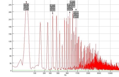

F) Electric fields exist any place you have 230V 50Hz. Standard way to check if 'scope or sound amplifier is working is to touch input with finger! Trace below is touching 1 megohm 'scope input - "cleaner" trace is with other hand touching earthed painted metal of computer case.
Fluorescent light tubes are usual & most cables keep "go" & "return" [H field] & Live/Neutral/Earth [E field] close together which cancels a lot of remote field. However, in tube fitting neutral is buried in earthed steel, cutting its E & H fields - while tube is a gas conductor which is often not in any way shielded & is spaced farther from neutral than in cable.
This is the "E" field of my network router with probe 10cm away from [DC] power entry.....
The spikes at 50 Hz are short & 6000 peak. The spectrum fundamental is 280 peak, but harmonics are similar amplitude up to high numbers - a feature of a pulse.
So your field could be from lots of electric items - try putting E probe close to some.
