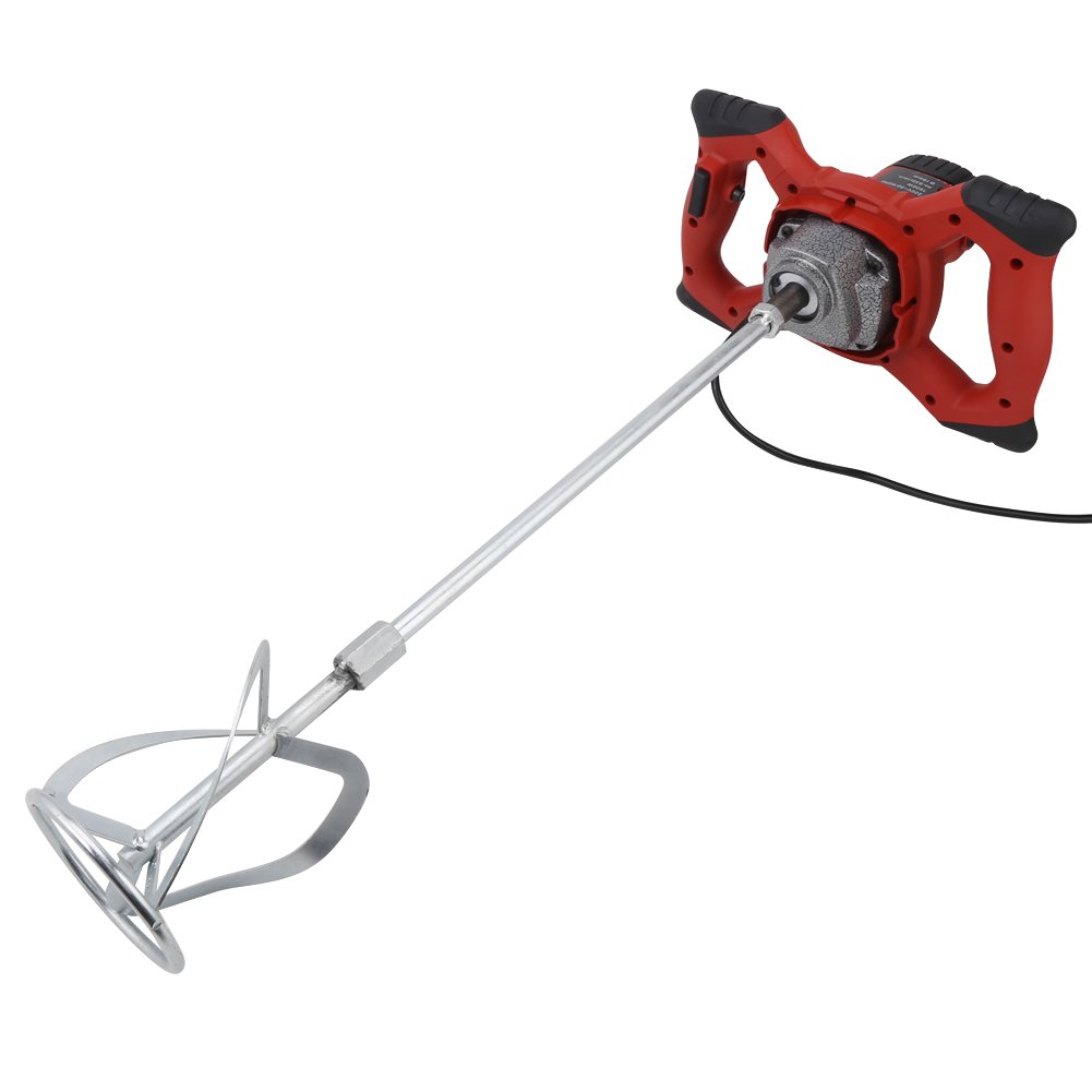

Hey for $65 just get one of these....
A tool designed for purpose works much better....
