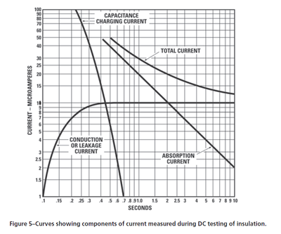

Megger.com have a document called "Stitch in Time", which explains why insulation resistance reading changes during a test & over months of repeat tests & how to interpret it to judge condition of machine.
You will find it if you do a search of their website - you will have to register & log-in before you can download, which is no problem if you are a genuine machine user.

01/20/2019 4:47 PM
This is one graph from "Stitch in Time", showing initial currents.

http://eecoonline.com/motor-repair-best-practices-polarization-index-test/_
It looks like you are applying enough potential during your test to use a polarization index test method to evaluate the insulation condition.
This could be an expedient method to evaluate the insulation, though the fact that it charges up shows the insulation is good. If you use a lower voltage for the test, the charging effect will not be as noticeable. This appears to be a large machine or a high application test voltage. My experience in observing similar circumstances is 4000 volts on a 3000 hp machine, open frame engine type synchronous salient pole machine.
