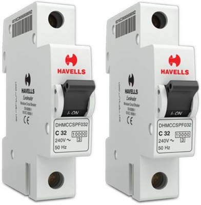

what is the technical difference between dual voltage and single voltage MCBs?

The reason for the marking is to indicate that they can be installed in either a single-phase 230V system (as found in most houses here) or in a 400V-3-phase system. If they are not so marked, then they cannot be used in the 3-phase.

Voltage Rating [Secs. 240.83(E) and 240.85]. Breakers are marked with either a slash or straight system voltage rating that indicates their capability to interrupt fault currents.
Voltage markings for breakers with slash voltage ratings are separated by a slash — for example, 208/120V or 480/277V. Each pole of the breaker is suitable when the line-to-ground voltage does not exceed the lower voltage marking, while the higher voltage marking is the value the line-to-line voltage may not exceed. Single-pole breakers are always slash rated.
Although the Code permits you to install a 120/240V slash-rated breaker on a 120/240V 3-phase, high-leg delta system, you cannot install it on the “B” phase (high-leg), because the nominal line-to-ground voltage of the high-leg is 208V. This exceeds the 120V line-to-ground voltage rating of the 120/240V slash breaker.
Be careful when installing slash-rated breakers on a solidly grounded high-leg delta system. Do not install them on corner-grounded, resistance-grounded, or ungrounded systems.
You cannot use a slash-rated 480/277V breaker on a 480V corner-grounded delta circuit because the line-to-ground voltage from two of the conductors would be as high as 480V. This exceeds the breaker's 277V line-to-ground voltage rating.
Two-pole breakers can be either slash or straight voltage-rated, whereas 3-pole breakers are all straight voltage-rated.

The single voltage rated MCBs are acceptable for line to line or line to neutral loads at voltages up to 240 VAC.
The double voltage rated MCBs are acceptable for line to neutral loads at voltages up to 230 VAC, and line to line voltages up to 400 VAC.

WRONG! The article above clearly explains the difference.
The breaker must be able to clear a fault to GROUND,as well as a line to line fault, and ground is not the same as NEUTRAL.
The lower voltage rating is the rating of the voltage to GROUND.
People tend to think of neutral and ground as the same,but they are not.
The higher voltage is the rating LINE to LINE.
Keep these facts in mind when you read the NEC article above.

It means that the single pole breakers rated 400/230V can be installed only in 400V neutral point earthed systems where Phase-to-ground voltage during healthy conditions doesn't go beyond 230V.
In case of single phase to ground fault, the unfaulted phase to ground voltage may go over 230V (until the fault is cleared) but that is not a concern.
Hope I have understood correctly.
