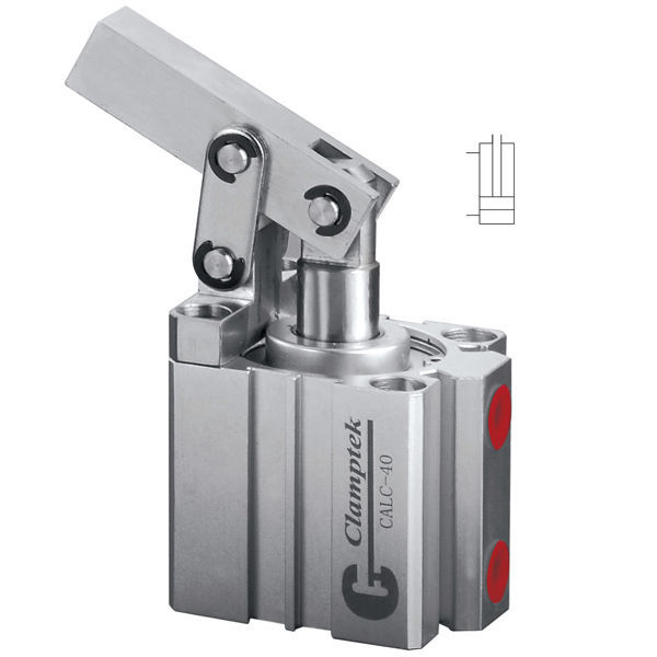

This should do it. Just add a simple mechanical release mechanism
Re: Stopping of A Steel Rod
02/04/2019 4:16 PM
02/05/2019 3:10 AM
Adding unnecessary complexity...
Your geometry is of too

02/05/2019 2:18 PM
02/05/2019 2:50 PM
02/05/2019 5:14 PM
LOL
02/05/2019 8:39 PM
02/06/2019 12:55 PM
02/07/2019 5:35 AM
Ah!
Good old Pneumatics still lives!
02/26/2019 10:33 AM
Ye gods! There it is, all designed, built and everything!
