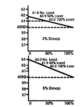

Re: Steam Hunting When it was Synchronised
04/03/2019 5:21 PM
It sounds like the TG's are not sharing the load (real power).
The governors on the turbines have a characteristic called droop, which is the response of speed to power.
If a machine is supplying power by itself, the droop is set to flat (isochronous) so that the output frequency will be stable when the load changes. When you parallel a second machine, its governor should be set in droop mode. While the first generator's (master) governor maintains frequency, the second machine's governor can then be adjusted to share the load.
Check the governors' droop setting.
http://www.woodward.com/WorkArea/DownloadAsset.aspx?id=2147483661
https://en.m.wikipedia.org/wiki/Droop_speed_control
04/04/2019 5:50 AM
Sounds like you need a turbine and generator controls consultant.
Be very cautious if your turbine speed governor has an isochronous setting, in control, if you have that option. One would want the droop governors of both (all) units set the same, if you want them to equally share the load swings. Finally, do not put the zero droop (isochronous) unit into service until the human operators have the islanding (disconnected from the grid) situation stabilized. Probably with a cement plant carried inside the island, that is impossible.
Also, I found that the original posting was hard to follow, because the numbers didn't seem to match. In an islanding situation, the real power produced and consumed has to match 100%. Watts that do not match, instantaneously, cause the machine to accelerate or slow down as kinetic energy is stored in or removed from the rotor (inertia).
Same thing for the reactive (called imaginary) power. If the VARS produced and consumed don't match, instantaneously, the voltage will rise or fall until the excitation system responds or the generator protection system trips the breaker.
