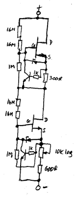

Re: Any Idea About Constant Current Source for 5,000V Power Supply?
04/24/2019 6:40 AM
You need something like these - two in series - unfortunately, could not get data sheet so amount of leakage etc not to hand. FET biased to low current is good current source & an op amp feedback from source current to gate can make it better.
https://www.mouser.co.uk/ProductDetail/IXYS/IXTF02N450?qs=%2Fha2pyFaduj6YwmeOD9vmYilPwVkmpeV%252BRHX8vvHVmDBuUt4SljRNQ%3D%3D

Posts: 1686
Good Answers: 116
04/24/2019 3:29 PM
Something like this using that IXTF02N450 FET....
Data curve shows FET is DC safe to 2 kV @ 20 mA. Both FET have current clamp, so if one goes into drain-source breakdown the other will limit current. If you want 5kV; then you need 3 FET in series. The 16 Meg resistors are TT Electronics VRW 3500V [VRW68 10 kV, up to 68Mohm]. Zeners 8V2 to protect gate-emitter insulation[ ~5V Vge at mA current]. The FETs must be well heat-sinked - breakdown failure is dependant on temperature.
The minimum regulated current is limited by 16 meg resistors to about 75 microamp - you indicated 0.1 to 1 mA - also means voltage can reach 5 kV with very high load resistance.
Transistors [BC109 or equiv.] conduct to regulate current at 2 mA for upper FET, up to 1 mA for lower. Regulation is good, except for temperature sensitivity of BC109 emitter-base voltage ~0.5%/'C. Clamping BC109 on Al block to make change slow may be OK. An OPamp with stable reference can improve that - I would leave transistor clamp in place with 2 mA limit & have Opamp pull-down gate via diode.

Hello 67model: ,
Yes, this is what I feel may work well.
I have maximum current through 5000V is 1mA 5W power supply.
1:100 regulation means 10uA to 1mA range. This obviously need high voltage higher value resistors due to low power to waste. Less than 10uA sounds too low at this time.
1000V #5 JFETs of gate source current of 2mA will do. I am not sure if low leakage 1uA current JFET will be there for 1kV or higher rating.
I will sure look into these.

Posts: 1686
Good Answers: 116
04/27/2019 10:37 AM
Your original post asked for 100μA to 1 mA; the 16M resistors give ~100Mohm for 3 FETs in series or 50μA with output shorted & 5 kV input.
As noted VRW68 resistors [10kV] go to 68Mohm giving ~12μA plus FET leakage. N.B. that would be ~6μA with 5kV in 2.5 kV out to device under test.
IXTF02N450 Maximum leakage at 25'C is 10μA @4.5kV - typical will be much less, also 3 FET in series will see 1.7 kV each - since leakage is probably exponential with voltage, that will fall a lot. N.B. exp(4.5)/ exp(3.6) ≈90/37 ≈ 2.4 : data sheet maximum Idss(4.5kV)/Idss(3.6kV) = 10μA/5μA ≈ 2. Since exp(1.67) ≈ 5 one can expect Idss max ~0.5μA @ 1.7 kV - "typical" is usually 1/5 to 1/10 of max [50% of devices < typical?] - so it is probable you will get < 1 μA leakage from these FET.

Posts: 1686
Good Answers: 116
05/01/2019 6:19 AM
If you require a faster response, I suggest powering the BC109 from an MN1604 alkaline battery [3k9ohm resistor to battery + from collector] - you can get the potentiometer with a switch & 50mm nylon shaft to isolate 5 kV. Battery life of 100 hours OK for test purposes.
The input capacity of the FET is 250 pF, which means settling times of ~1 ms at turn-on. Since one device, fig.13-14 of data sheet is safe for 300 mA/4.5 kV/1 ms @ Tj = 150'C, this should not be a problem.
