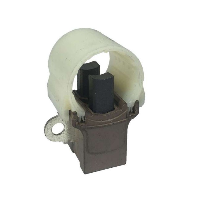

I’ve heard a story that in a vehicle alternator (conventional type, cylindrical sliprings and brushes) one of the brushes wears quicker, due to different polarity hence direction of electron flow. The source couldn’t say which one, +ve or -ve, wears quicker.
I checked on a couple of old alternators (I used to repair and sell them many years ago) and both have different brush lengths, so it could be true, though I can’t think of a reason polarity would affect wear.
Also that the type of voltage regulator affects brush and slipring wear, machine sensed (reference voltage direct from the 3 field diodes) being worse than battery sensed, (reference voltage via a separate lead from the battery). The only reason I can think of that could cause that is battery voltage being more stable, hence steadier field current.
Can anybody please comment?

My observation on the brush wear is that I have noticed the same effect but deduced that the wear was on the brush furthermost from the bearing and therefore less protected from the dust ingested through the alternator acting as fine sand paper which is what is used to bed brushes in.

The rotor in a vehicle alternator is the electromagnet that then induces a voltage in the stator field, the stator produces the AC. The brushes carry only DC to energise the electromagnet
Alternator brushes generally last considerably longer than generator ones due to lower currents and an unsegmented surface to run on.

Yes, you wouldn't expect them to wear at exactly the same rate. The claim is there's a consistent difference due to polarity.

It would be nice to think so, but see my #15. Early Lucas ones had one brush more prone to wear from its position and the polarity effect, if I've got it right.
Of course alternators nowadays AFAIK all have cylindrical sliprings, and life is pretty good. I've done 205000 miles in my car and no alternator problem yet. Not bad for bearing life, apart from brushes and controls. Maybe helped by being controlled via the engine management system.

Hi Codemaster but just to add to the confusion I have a number of alternators salvaged from Japanese cars. Some have cylindrical sliprings and some have concentric slip rings which one would think would cause the outer brush to wear more due to the higher peripheral speed.
As for regulators, some require the battery connection through the lamp to establish initial excitation and unless this connection is made it is game over. Alternators come in all manner of connections, 2 wire, 3 wire 4 wire. I just installed an alternator onto an old BTD8 inter dozer and it needed the lamp circuit to establish initial excitation.
Regulators, gone are the days of discrete components in the box, no now it is all potted and a throw away item but replacements can be bought at a reasonable price or if too expensive then an alternator change becomes cheaper.

The only ones I've seen with concentric sliprings are the early Lucas ones, but it seems there are others. The outer one does wear quicker, I've seen it many times.
Unlike a generator (dynamo) an alternator needs the lamp for initial excitation. When I first read about that I was sceptical, thinking there should be enough residual magnetism to get it going, but when I tried it without, the book was right!

I understand it depends on the kind of brushes, carbon or metallic. I'm not sure anybody knows why.
"An investigation of the effects of polarity and current density on the rate of wear of electrical brushes is reported in this paper, following a brief review of previous experimental work in this field. For carbon and copper impregnated carbon brushes the rate of wear of the positive brush is considerably less than that of the negative brush, while for metallic brushes the situation is reversed. The rate of wear of metallic brushes was found to be much greater than that of carbon brushes, under conditions of these tests. While no complete explanation of brush wear can be derived from the results, the rate of wear seems to be related intimately to the conduction of current across the contact."
https://ieeexplore.ieee.org/document/6540712

The early-ish Lucas alternators (15/16/17 ACR) had face-type sliprings on the end of the shaft, one nearly concentric with the shaft, the other at a radius ~ 12mm. Brushes carbon of course. Unsurprisingly, the outer brush wore quicker, lasted about 80000 miles, at which point you could swap them as a stop-gap.
But the inner brush is the +ve, so from your link the outer gets it from both effects. As far as I can tell, at design stage the polarity could easily have been reversed. Perhaps Lucas weren't aware of the polarity effect at the time - early 1970s.

The one item not touched on is the voltage sensing. Battery sensing allows the regulator to directly measure the critical variable, cell voltage. If measured at the alternator, you have to account for the voltage drop of the wiring, which varies directly with the charging current.
Modern regulators adjust charging according to battery cell temperature, charge state and load. I assume that is why my 2008 Saturn Outlook 195,000 miles still has OEM battery, behind passenger front seat in fully instrumented compartment, current shunt, voltage sensor leads, and temp sensor. (Admittedly North Carolina weather for 90% of life, not much upstate NY or New England in winter )

I still can't see any obvious reason machine vs battery sensing would affect brush life, apart from what I suggested in original post.
