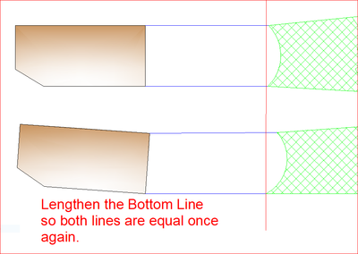

The drawing above shows 1/2 of an Otter Trawl complete with Otter Doors ( big brown thing).
When new gear is deployed, the trawl net and the Doors ride nice and flat on the sea bed.
However, when the gear is older, the lines, cables, netting...are stretched somewhat and the Doors begin to ride "Off Bottom", Cantilever...
The age old solution is to simply shorten ONE of the Blue lines. Which one is the question?
A Fisheries Technician and I had a difference of opinion. I said shorten one line, the Tech said shorten the other. * I have done this for 35 years....however the young "tech" thinks differently.
To settle the argument he agreed to an impartial board of people who had NO direct contact with Fishing Gear....only a deep knowledge of physics and such.
I suggested CR4....you guys.
So, please speak up: Which line , TOP or BOTTOM gets shortened to drop the Otter Door back in somewhat even contact with the sea bed.

Tighten the bottom line or loosen the top.

If I understand the steering mechanism correctly you need to tighten the upper line to steer the net lower...

Are the tops of the boards leaning one way or the other? Or are they always vertical? From my perspective it could be either...
But my gut says lower

Lets try again. I added some more information that may help.
* The Chain bridles are tied up for shipping. when opened and in full array, they produce an angle of attack of 38º.*
These Trawl doors are referred to as Otter Doors. They are the most common used in the Research and Sampling field as they are extremely simplistic ( and in-expensive)
Their design dates back to 1500 France.
The nets attached to these Otter Doors produce 65% of the bollard pull of the entire gear.
Some of the doors shown on your answers are "V" doors which have a totally different High-Low pressure gradient than the older design Otter Door.
Midwater or Pelagic trawls tow entirely different also and have another more complicated design .
Also, these Otter doors, have 2 (two) bridle or leg lines...one TOP and one BOTTOM.
Can we look at it again. I can't give hints.
TOP line has more tension, than does the BOTTOM Line.
Line going to boat is at a steeper angle than the Top Line has rising due to the design and the floatation on the net.

Although the intuitive answer seems to be the opposite, I think there is a simple way to explain it. When the rig is first set up the two lines are of equal length; during use the greater tension in the top line stretches it and the closely related portion of the net; to restore the status quo you need to shorten that line.

If you know the original line lengths and you can measure how much they have stretched, then why not shorten the lines to their original length?
