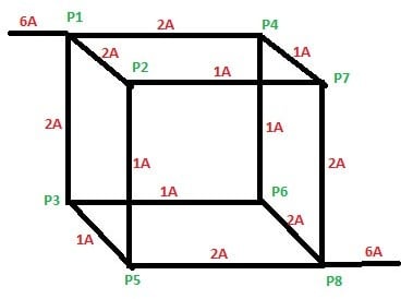

What is the Resistance of This Circuit, and How is it Calculated?
05/05/2019 11:22 AM
each resistor has a resistance of 6 ohms

You could use Y-Δ formulas, but there's an easier way since all the resistors are the same. Current fed in from one corner splits equally 3 ways. At the end of each of these, it divides equally 2 ways, and two equal currents combine in each of three paths to the exit corner.
Suppose you feed 6 amps into the corner. Each 6 ohm resistor will have 2 amps for a drop of 12 volts. When the current splits two ways, each resistor will have 1 amp or 6 volt drop. Finally, there is a 12 volt drop to the final corner, a total of 30 volts for 6 amps or 5 ohms resistance between the corners.

Here is a picture to clarify #1:
1. 6A current enters P1 splits 3 ways, 2A each
2. 2A enters P2, P3, P4, splits 2 ways, 1A each
3. 2 x 1A current merges at P5, P6, P7.
4. 3 x 2A current merges at P8.
5. Voltage at P8 = 0;
6. Voltage at P5, P6, P7 = 2A x 6Ω = 12v
7. Voltage at P2, P3, P4 = 12v + 1A x 6Ω = 12v + 6v = 18v
8. Voltage at P1 = 18v + 2A x 6Ω = 30v
9. Resistance = 30v / 6A = 5Ω
Reply Good Answer (Score 7)

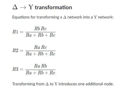

AP#1 probably ought to check out those Δ-Y and Y-Δ transform formulas just in case!
https://www.khanacademy.org/science/electrical-engineering/ee-circuit-analysis-topic/ee-resistor-circuits/a/ee-delta-wye-resistor-networks

On the other hand, I'm virtually certain that Rixter's methods are correct, giving a value of 5Ω, and that value was confirmed by at least one other poster, so I suspect that you have an error somewhere.
Since all the resistors have the same 6Ω value, the unit is symmetrical, so the voltages at the non-supply ends of R1, R2, and R3 must be equal. If those three voltages are identical, then those three points can be connected together, and nothing will change. Once you make that connection, you have R1, R2, and R3 connected in parallel, and thus equivalent to a single 2Ω resistor.
Do the same with R10, R11, and R12 and you have another 2Ω resistor. What's left is 6-6Ω resistors in parallel, which is of course equal to a single 1Ω resistor
Now you have a series of a 2Ω, a 1Ω, and another 2Ω resistor, which of course add to 5Ω. Having done that, I'm now confident to remove the word 'virtually' from paragraph 2 of this post.

Alright, I've been sucked into this. Because all of the resistances are equal, here is another method that works, and uses only the value of the resistors, without introducing current flow or voltage drop into the calculation. I use Rixter's drawing (post #6) because it visually clarifies the problem.
From P1 and P8 the two tri-branched resistor arrays are resistors in parallel, so the total of each array is 2 ohms (1/Rt = 1/6 + 1/6 + 1/6).
Consider those two arrays now as two equally resistive plates between which the remaining 6 resistors are connected in parallel. Their total resistance is 1 ohm (1/Rt = 1/6 + 1/6 + 1/6 + 1/6 + 1/6 + 1/6).
Therefore the circuit is equivalent to two 2 ohm resistors and one 1 ohm resistor in series, for a total of 5 ohms, which agrees with Rixter's result.
