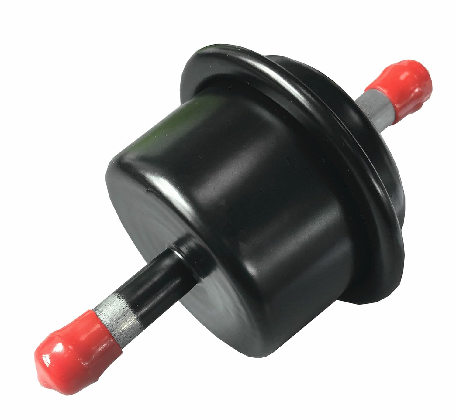

Good day to all!
I own a Honda CRV 2011 which has 130,000 km (aprox 90 K miles). For 100,000 km all services were made at Honda, from there on, at a mechanic in my neigborhood.
Recently a friend asked If I had the "automatic gearbox serviced"... also saying that there was a certain filter inside, which -if not timely replaced- would cause terrible things to happen.
Here I have to say that automatic gearboxes are not very popular down here because people "who really like driving" prefer shifting gears (!!!??).
I asked my mechanic, who scratched his head and said something like: yeah ... hmmm, filter.... and later explained that there is a filter to be changed located in the depths of the gearbox, and that changing it is like performing a brain surgery.
The guy at the oil change place said they do a "partial oil change" meaning they drain only the oil "from this part of the gearbox" while there seems to be oil in "another (seemingly secludad) part" that cannot be changed. This "partial oil change" is of about 1 galllon, while 2 more gallons seem to remain inside. He also agreed with my mechanic about the filter saying that the gear box had to be removed to do so... and that there was a risk of damaging certain misterious and VERY expensive sensors....
As all car factories earn a lot of money selling "original parts and consumables" I wonder why Honda would make the access to such a part so difficult if regular changes were needed.
Please enlighten me about this matter!

Re: Automatic Gearbox Maintenance?
05/20/2019 9:23 AM
Ha ha sounds like your mechanic is planning on taking you for a ride...the filter is actually mounted outside the transmission and can be changed in a few minutes, cost about $8.....
The whole job less than $60 in materials...
https://www.crvownersclub.com/forums/19-maintenance-service/156201-2011-transmission-fluid-change-119-a.html

no special pump needed, disconnect the line that goes to the radiator. you can figure out which is supply and which is return by starting the engine. the tranny pump will empty the fluid for you.
05/21/2019 12:07 AM
Hi R&D,
I highly recommend changing the transmission fluid and while you're at it, change the filter. The Honda CR-V is a great little SUV, but Honda's have one weak spot - automatic transmissions ... well, the other weak spot is overheated engines due to coolant leaks (their heads damage easily), but that's another thread.
Okay, back to the tranny. The fluid that's "stuck" in the transmission is in the torque converter. The torque converter attaches to the flexplate (like a flywheel on a manual transmission setup). The torque converter is filled with transmission fluid and allows slippage from the motor (flexplate) to the input shaft of the transmission. The torque converter also functions as a torque multiplier using fluid flow through vanes.
Why does the fluid need to be changed? Heat is generated in the torque converter and the transmission. The heat breaks down the transmission fluid, so by100K miles the transmission fluid may have become slightly brownish vs bright red when new. The fluid is no longer doing the job it should and must be changed. When you drain the fluid, check the condition of the old fluid. If it's bright red, you're in good shape. If it's slightly dark red/brown, you're most likely still in good shape, but you should get all the old fluid out. If it's dark brown and smells bad, you have a big problem - dump the old fluid back in and keep driving until the tranny dies. If the fluid is slightly dark red/brown, you can get all the fluid out by powerflushing, but it's not recommended. Doing the drain/fill/drive, drain/fill/drive ... routine is the best way to do it.
And change the filter. It's cheap insurance - if there are particles in the filter, it could come to a point where the fluid doesn't flow enough due to the debris. Also, there's a chance the media in the filter could break and all that junk goes back into the transmission.
One last tip - the drain plug on automatic transmissions is usually magnetized, so any iron particles will "stick" to the drain plug. When you pull the drain plug, make sure you clean it and check for particles. A little "metal dust" is okay, but if there are chunks or too much dust, you're in trouble.
Since automatic transmission are rare where you're at, the cost of maintenance could be much higher. Your mechanic has to "learn" how to properly change the filter and fluid, so he's going to bill you for the education. There are also very few "professionals" who know about the Honda CR-V automatic transmission, so you'll pay a premium. Here in the US, most of us have automatic transmissions. Back in 1985 or so, my sister had a 1981 Pontiac Firebird with a TH 200 transmission (cheaply made transmission). The tranny died at around 41K miles, so I had it towed to the transmission shop and they swapped it out for a rebuilt TH 350 - labor, parts, fluid, shop supplies, etc. Total price $195! The TH 350 was a much better tranny. Of course, being a 301 Pontiac engine with a smog Quadrajet, it was not only gutless, but it wound up losing a bearing around 68K miles. We made some pretty pathetic cars in that era.
Sorry to get off subject. Good luck and happy motoring!

the filter does not need to be changed. it will last a lifetime. old time filters made of cloth or fiberous polymer did need replacing but these are a metal mesh and will be fine. the fluid change that they usually do is not as good a way to do things. there is a lot of oil in the torque converter. the proper way to replace the oil is to disconnect the line that goes to the radiator and put it into a large bucket. while someone is sitting in the drivers seat, you will need to have your new fluid ready to fill, as the engine is started, the pump will drain the old oil into your bucket while you are pouring new fluid into the fill port. once you see the oil change from a dark brown to the light red color, have the friend shut the engine off. attach the line back to the radiator and run for a while and check the fluid level and top off if needed. it too much is in, drain some.
this is the way to correctly do it.
