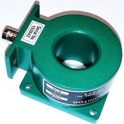

I also need ideas to sense such high current fast pulses to put them into oscilloscope.

I've used Pearson current probes https://www.pearsonelectronics.com/ on a number of occasions. They have worked well for me.
