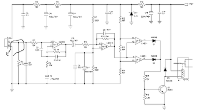

I have purchased solar night lamp on line recently.Actually I wanted that its should get switched on automatically when there is no light (dark) and remain like this till gets discharge.
But what I received is, it gets on when senses some object and gets switched off as the object is gone. There is a snesor for sensing object.
I want that is should remain continuously on without sensing any object, means it should be 'on' automatically sensing darkness ( No object) and remain like this till charge lasts.
Can any one help/suggest how to get this option? I have tried with covering the sensor with black tape but it does not work.
Thanks

You have not explained much about what you have....
You must have a battery. You have a lamp, turned on by "no-daylight" AND movement detector usually infra-red PIR. Probably battery charged by solar panel, but solar panel can double as light detector.
Diagram above is about simplest way such a system could work.
  1. The FET acts as a switch for the lamp. It will switch on if voltage at its input, at left, is more than 4 volts. Resistor Rf will put the FET ON, unless something connects FET input to negative (-).
  2. During day, transistor L is turned on by high voltage from solar panel using zener diode Z, which conducts only above a certain voltage - no voltage in dark. In day FET & lamp are off.
  3. At night L is off, but movement detector PIR transistor P must also be off for FET to switch on - so lamp will come on with movement.
If it is really so simple, then cutting wire "y" from PIR will get what you want. Cutting wire from PIR to + positive supply would probably work as well.
Try to cut wires where you can easily reconnect them by stripping insulation & twisting ends together - resolder if you can.
Let us hear how you get on....

Popular type of detector - extreme left of diagram - in 3 lead TO5 cylindrical housing can be disabled by shorting two pins circled together; that is the two pins which are not connected to positive supply.
