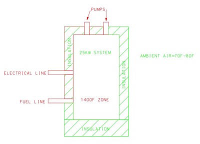

Join Date: Nov 2019
Posts: 3
Re: KW to Temperature (Degree F)
11/06/2019 10:14 AM
thanks for all the feedback. I think i now have what i need.
Again, my goal here was to spec out the right insulation coverage to not allow more than 5KW of heat lost.
Example sketch.
11/06/2019 11:56 AM
Unfortunately, your sketch only adds to the confusion! You originally said nothing about a fuel; if you are burning a fuel inside a closed furnace, there must be an exhaust to remove the combustion products. That exhaust will carry a great deal of heat, over and above the heat losses through the insulation.
You show the 1400° zone near the bottom of the enclosure. Since hot gasses are lighter than cooler ones, they tend to rise to the top of the enclosure. What is the temperature there?
You show the electrical line well up the side of the furnace, but don't show the placement of the heating elements. The placement of those heating elements would have a significant effect on the temperature distribution inside the furnace. I'm assuming the current 25kW and desired 5kW both refer to the electrical power only.
You show "Pumps" at the top of the furnace. What product are you able to pump, and what kind of pump do you use that can cause flow in that 1400° material?
